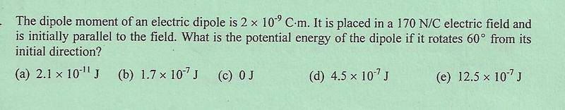

There are two problems attached that illustrate my confusions, but my questions is more general than this specific example.
For the first problem where we are asked for the potential energy,
When the dipole moment is parallel to the electric field, it has 0 potential energy.
[tex]U_{i} = - \vec{p} \cdot \vec{E} = 0[/tex]
When the dipole rotates 60 degrees, the potential energy is not 0.
[tex]U_{f} = -\vec{p} \cdot \vec{E} = -pEcos\theta[/tex]
The potential enegry given from the formula is negative, but there are only positive answers as possibilities.
I know it is obvious to choose the positive one that corresponds to our answer, but sometimes both negative a positive quantities are listed as possible answers, and I am often confused on which one to choose.
Why is that negative sign in our formula for potential energy, what's its purpose?

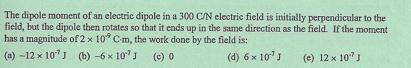

For problem number 2 where we are asked for the work,
Initially there is 0 potential energy in the system (perpendicular),
[tex]U_{i} = 0[/tex]
but then the dipole rotates such that it is parallel to the direction of the field so,
[tex]U_{f} = -pE[/tex]
Now,
[tex]W = \Delta U = U_{f} - U_{i} = -pE - 0 = -pE[/tex]
It seems as though the work is negative, but the correct answer is that it is positive.
What am I mixing up?
What do I need to think about and be consistent with to eliminate these sign errors?
Please be as clear as possible. A good example to remember how to determine the sign would be excellent.
Thanks again!
