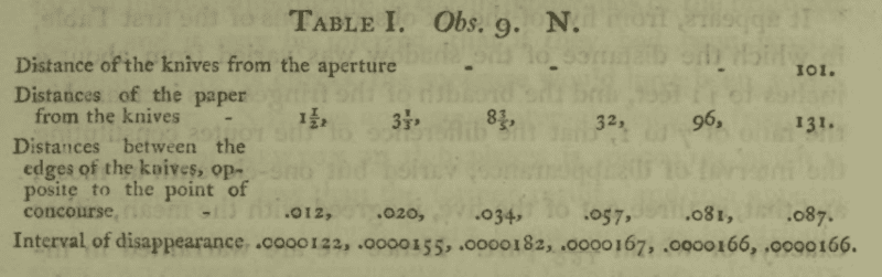

First there is the article by Thomas Young himself where he presents his famous double slit experiment.(Can be found on the web). A second example is with the use of the Michelson interferometer by a M.I.T professor which can be found at
The single slit envelope is very present!
I'm afraid I don't understand your position. If the single/double slit interference pattern never disappeared Quantum Mechanics would not exist.

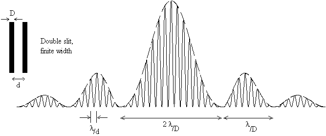

@Nugatory gave it a shot. I find it hard to improve on hyperphysics. Perhaps a clarification: they distinguish diffraction (single slit) and interference (double or more slit) for . The first doesn't go away when more slits are present:
and you can play with the check boxes
When you learn about Fourier transforms:
A double slit aperture is the convolution of a single slit and two delta functions. The pattern on the screen for the first is a a sinc (##\ ={\sin x\over x }\ )\ ## and for the second it's a sine. The pattern for the convolution (a double slit) is then the product of a sine and a sinc. Since the width of a slit is necessarily less than the distance between the delta functions, the peaks in the sine are closer together than the peaks in the sinc. Sheets 25, 29 and especially 30 here .
Does that help ?
elou said:
First there is the article by Thomas Young himself where he presents his famous double slit experiment.(Can be found on the web). A second example is with the use of the Michelson interferometer by a M.I.T professor which can be found at….
Those are electromagnetic wave phenomena that have little to do with quantum mechanics and were understood and explained by classical mechanics a century before QM.
