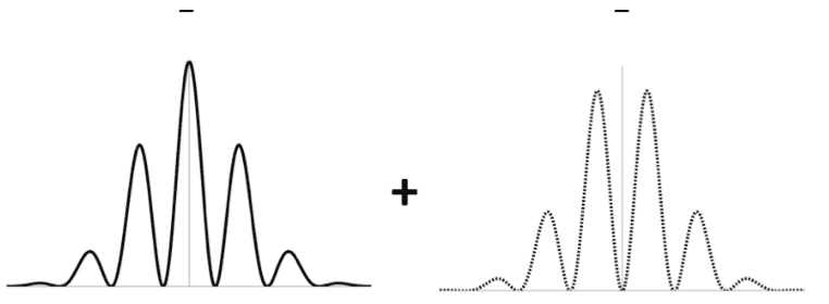

More of a wave optics question. Is it the case that the two waves from each slit cannot interfere at all, resulting in two superimposed single slit diffraction envelops at the screen? Or is it that the positive and negative diagonal components create a fringe and anti fringe interference pattern superimposed on the screen?
1) Very simple setup: a light source sends single photons towards a double-slit setup. After slit A there is a horizontal polarizer, and after slit B there is a vertical polarizer. Finally, there is a back screen.
In this setup we will see no interference pattern, despite the fact that there are no detectors and thus no which-way data being obtained. There are many explanations for why we get no interference pattern at the screen, and I am trying to figure out which is correct.
2) Very simple quantum erasure: Exact same setup, but now we place a 45º diagonal polarizer before the back screen.
Now the interference pattern reappears! And, interestingly, if we place a -45º diagonal polarizer before the back screen instead, we get an "anti-fringe" interference pattern instead.
THE QUESTION: There seems to be two possible explanations of what is going on here: The first explanation is that, when the waves from each slit are orthogonally polarized they cannot interact with each other because their electomagnetic oscillations are perpendicular to each other. Thus, what we see at the back screen is two single-slit diffraction envelopes superimposed onto each other. Placing the diagonal polarizer before the screen transforms the wave oscillations so that they once again interact, reproducing the interference pattern at the back screen. The second interpretation is that the diagonal components of both waves are always able to interact. 50% of the time the 45º components interact, producing a fringe interference pattern, and 50% of the time the -45º components interact, producing an anti-fringe interference pattern. When these two interference patterns are superimposed over each other, they produce what looks like a particle pattern at the back screen. When a diagonal polarizer is placed before the back screen, it blocks one of the two diagonal component oriented possibilities from reaching the back screen, allowing only the others through. So if a 45º diagonal polarizer is placed before the back screen, then all -45º diagonal component oriented photons will not reach the back screen, and what ends up on the back screen is all of the 45º diagonal component oriented photons, producing a fringe interference pattern.
Maybe there are more options I'm not aware of, but what is actually going on here?

Wrong. The polarizers, since they are set at orthogonal polarizations, are giving which-way data. The fact that we don't have a device that can record that data for us to review later doesn't mean the data isn't there. It is precisely the fact that the polarizers are giving which-way data (even though it gets thrown away without humans reading it) that removes the interference pattern.

Yes, because the diagonal polarizer, since it is (a) oriented halfway between the two polarizers at the slits, and (b) oriented the same way for all photons, removes the which-way information that the horizontal and vertical polarizers created.
If you want to look at it that way, yes: this polarizer is oriented 90 degrees different from the first 45 degree polarizer, so it changes all of the phases by that amount relative to the first polarizer, which reverses the pattern.

I'll try a simpler explanation. Interference involves the superposition (addition) of two wavefunctions with complex probability amplitudes. If the wavefunctions are identical in other respects and the amplitudes are opposite, then you get totally destructive interference. Likewise, if the amplitudes are equal, you get constructive interference. Otherwise, you get something in between.
If the wavefunctions are different, then you get a cross term in the probability when you add them together (invacsuperposition) And, in particular, if the two wavefunctions have orthogonal spin states, then the cross term is zero and there is no interference.
So, it's all about what happens when you add two wavefunctions together.
Right, so an "anti-fringe" interference pattern, where the maximums and minimums are reversed from the usual interference pattern.
Yes, the regular "fringe" interference pattern.
Yes.

About the fringes: The fringe is first below, and the anti-fringe second.
My fundamental interest is this:
Scenario A: The orthogonal polarizers determining which-path information removes the interference pattern, and if the orthogonal polarizers determining which-path information did not remove the interference pattern we would see an interference pattern with them in place, rather than no interference pattern.
Scenario B: The orthogonal polarizers determining which-path information removes the interference pattern, and if the orthogonal polarizers determining which-path information did not remove the interference pattern we still would NOT see an interference pattern anyway with them in place, simply due to the affects of the polarizers.
I suspect Scenario B is correct. What I want to know is 1) Is Scenario B correct? and 2) What explains why we still wouldn't see an interference pattern if the wave function is not "collapsed" by the polarizers?
That diagram doesn't mean much to me, without more details about the polariser.
If you have a linear polariser and you rotate its polarisation plane, why would the fringe pattern shift? The path differences through the slit apparatus are the same for both polarisations and the patterns should be the same. So where does your idea come from?
That is essentially my question. I assume that whatever explains the fringe pattern shifting will also answer my question regarding scenario B above.
