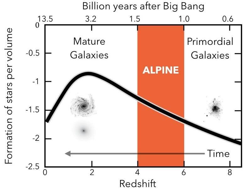

Hello collinsmark.
First off, thank you for the Dr. Becky video, which I listened to yesterday.
I'm beginning to see that part of my problem stems from not having a proper understanding of where (and when) these galaxies lie in relation to the Big Bang, the cosmic Dark Ages and the era of Reionization. Articles like this one, https://phys.org/news/2022-08-largest-image-james-webb-space.html , don't really help because the distances to various galaxies are given in two different ways.
Two interacting spirals galaxies are at redshift Z=0.7 but Maisie's galaxy formed within 290 million years of the Big Bang. One is a measurement of redshift and the other is a measurement of elapsed time.
So, is there a way of understanding how these two different scales compare to each other or better still, a way seeing their relationship presented graphically?
