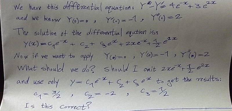

If my solution is right please tell me why I should omit [tex]2xe^{-x}+0.5e^{2x}[/tex]
You shouldn't omit the particular solution. The initial conditions apply to the complete solution, not just the homogeneous solution.
So the solution of my book is wrong as I expected!
In this case we have
[tex]c_{1}=4 c_{2}=-4.5 c_{3}=0[/tex]
They can't all be 0 otherwise you'd have y(0)=1/2.

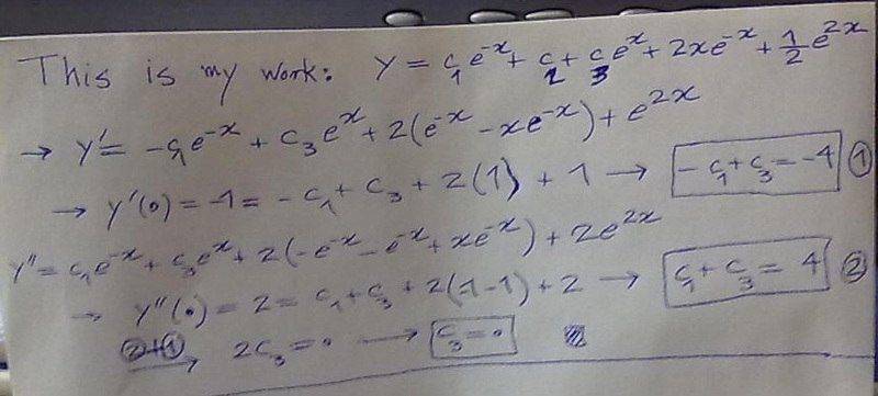

Thank you very much for your kind help. I know Laplace but I have to revise it now.
I actually solved it again and I got the same results:
[tex]c_{1}=4 c_{2}=-4.5 c_{3}=0[/tex] I mean again [tex]c_{3}=0[/tex]
Obviously, you're doing something wrong. Why don't you post your work so we can see where the problem is?
Oh, you did get the right answer. It's just that your equations ran together, so it looked like you got c1=4c2=4.5c3=0 so that all of the coefficients were 0.
If you're going to use LaTeX for something like that, you should put the equations on separate lines. :)
