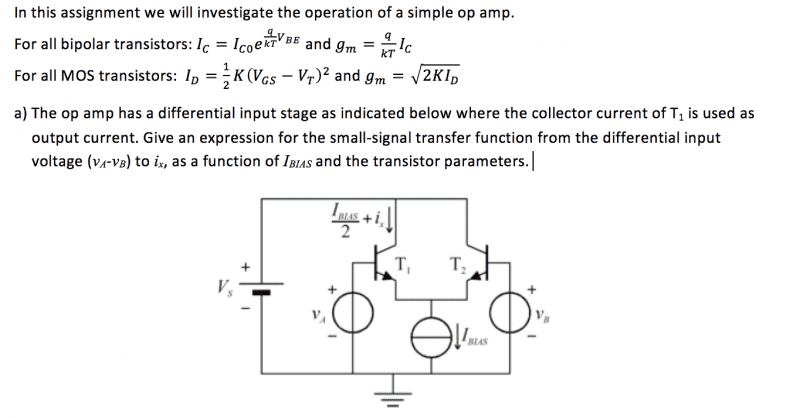

Small-signal transfer function from this differential input

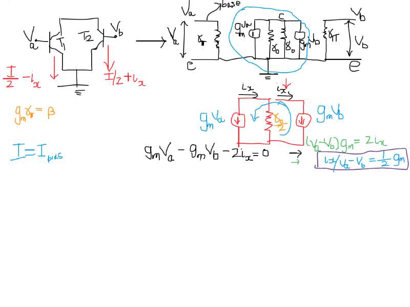

2. Homework Equations [/B]
Small Signal Equivalent Circuit, Kirchhoff Current Law, and BJT equations mentioned in the question.
It looks like I did something wrong. Can someone help me with fixing this?

I would not use equivalent circuits for this. You're given all the equations you need to solve the problem without resorting to equiv. ckts.
Hint: at some point use ex ≅ 1 + x for 0 ≤ x << 1.
OR you can do it with just gm.
I don't understand how you want to get to the answer 1/2*gm by only using gm and nothing else. And I don't see how e^0=1 would be related to this.
CorHawk said:
I don't understand how you want to get to the answer 1/2*gm by only using gm.
I'll get you started:
gm = dI1/d(Vb1 - Ve) = -dI2/dVe
where Vb2 = 0 is assumed wlog ("without loss of generality"). Vb is base voltage, Ve is emitter voltage.
That would come in handy if you choose to use I = Isexp(qVbe/kT) instead of gm directly.
I recommend using gm directly, it's shorter.
