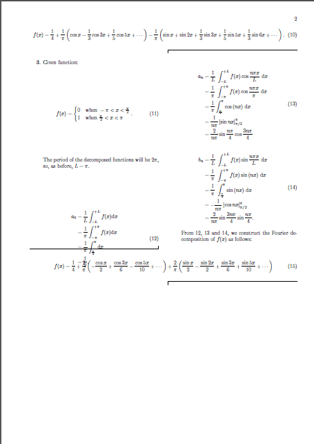

Our professor has asked us to submit our next assignment in ##\LaTeX##, and he has specifically asked us to use Revtex 4.2. This is not the first time I am working with this document class; in the past, I have used it several times. But I am facing an weird problem this time:
This equation was written with the following code:
[CODE title="LaTeX"]\begin{widetext}
\begin{equation}
f(x) = \frac{1}{4} + \frac{2}{\pi}\left(-\frac{\cos{x}}{2} + \frac{\cos{3x}}{6} - \frac{\cos{5x}}{10} + \cdots \right) + \frac{2}{\pi}\left(\frac{\sin{x}}{2} - \frac{\sin{2x}}{2} + \frac{\sin{3x}}{6} + \frac{\sin{5x}}{10} + \cdots \right)
\end{equation}
\end{widetext}[/CODE]
The problem is probably due to the fact that there is not much text content on this page; only equations:
Revtex is leaving a lot of gaps between the equations, which is not looking good as well.
I am using the following document class statement:
[CODE title="LaTeX"]\documentclass[reprint, amsmath, amssymb, aps, prl]{revtex4-2}[/CODE]
Any idea how to solve this problem?
The fact that the label (12) is centered between two lines of that equation might be related; perhaps use eqnarray with \nonumber on the first two lines?

Then that's not the issue.
Looking at it more closely, it looks like it's just putting the widetext wherever it happens to occur in the right column, irrespective of whatever is in the left column.
There's a thread on stackexchange which suggests that widetext (via one of its dependencies) is known for corrupting vertical spacing.
This https://www.researchgate.net/post/How_to_make_equation_one_column_in_two_column_paper_in_latex suggests instead putting your equation into a floating envireonment instead of an inline environemnt.
Is there a reason you don't just reformat the equation so it fits in a single column, e.g.,
$$\begin{align}
f(x) =& \frac{1}{4} + \frac{2}{\pi}\left(-\frac{\cos{x}}{2} + \frac{\cos{3x}}{6} - \frac{\cos{5x}}{10} + \dotsb \right) \nonumber \\
& {} + \frac{2}{\pi}\left(\frac{\sin{x}}{2} - \frac{\sin{2x}}{2} + \frac{\sin{3x}}{6} + \frac{\sin{5x}}{10} + \dotsb \right)
\end{align}$$ ?

Since our instructor is also helping us learn LaTeX, he has asked us to use at least two widetext environments. Otherwise I would have happily formatted the equation to single column, as I have done numerous times before.
By the way, wanted to post an update: the problem has been solved. The solution is nothing special: I just added one MATLAB graph as a picture and the overlapping was gone.

Could it be that it is split that is messing up the spacing? Does the same problem appear if you use eqnarray instead?
I don't know for sure, but it may just have been a problem with RevTeX. Personally I usually avoid using RevTeX when I can since it seems to have trouble with placement of things not unlike what you've seen, particularly when using the pra/prb/etc. options. RevTeX with these options produces slightly more compressed text than it does with the prl option and I wonder if it isn't taking this into account correctly. Conversely, formatting with the prl option generally seems to be okay, but then you lose the section numbers.

Submitted the assignment today. I could convince our instructor that using too many widetext environments doesn't look good. I used the align environment as suggested by @wle in post #5 and @DrClaude in post #11, along with the equation environment where necessary. The breqn package has a dmath environment that automatically breaks equations, and also allows breaking \left ... \right pair of delimiters. I eliminated the split environment completely. The figures were creating a problem sometimes, overlapping with text or going below the bottom margin. So I used the geometry package to specify the margins, and that partially solved the problem.
