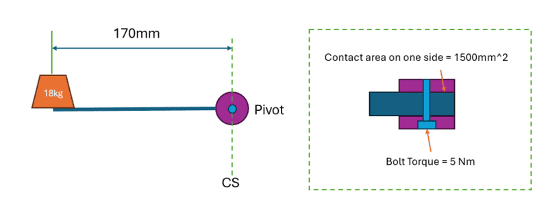

Hi guys, I am trying to design a brake/locking mechanism to hold up a weight, here is some background; I have a weight 18kg, 170mm away from the pivot point on an arm. A brake compresses the arm at the pivot point. This consist of a M10 bolt compressing a surface area of 1500mm^2 on each side of the arm. The torque I apply to the bolt/brake is 5 N/m. The CoF is 0.3. Will the brake hold up the weight? I am struggling to find the correct formula for this calc online. I know the weight will produce a torque around the pivot point of approx 30Nm. The clamping force I think would then be Torque/(CoF x bolt diameter) = 2.5 Nm. Is this correct?
On a different not why does a taper help with these kind of friction brakes? I've seen it mentioned online but I'm not sure why. If the contact surface was at a 15° angle what would this do to the calculation?

Thanks for the feedback. Does the below illustration help?

What are the inside and outside diameters, of the friction pad annulus?
Pressure is not important in friction, force is important. The area of the annulus is not important, but the average radius is. In this case, we need to know that the force is distributed evenly, radially over the annulus.

Understood. Lets assume the inner diameter is 12 mm and the outer is 40. How do we calculate the force in the case of flat 'brake pads' on the arm?

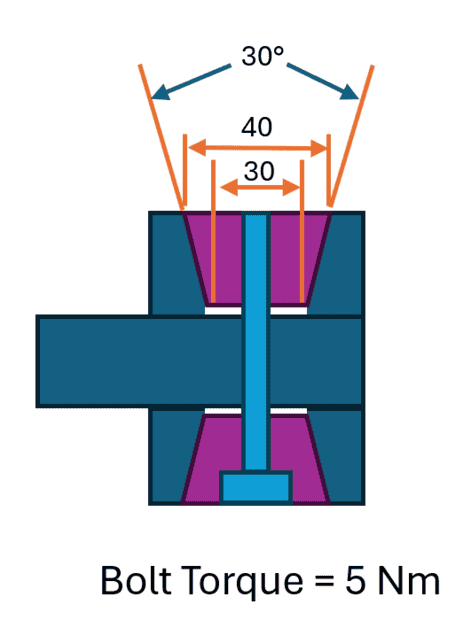

And then what changes in the calculation when you go to a conical bake pad like shown below? I know that this set up will give a better braking output but I'm not sure how to calculate this

ID = 12 mm; IR = 6 mm. OD = 40 mm; OR = 20 mm. Average radius = 13 mm.
From earlier; bolt axial force = 5 Nm * 17.8 * (1000 / 4.25) = 20.944 kN.
The two surfaces are in parallel; With CofF = 0.3
2 * 0.3 * 20.944 kN = 12.57 kN, acting at 13 mm.
The lever arm is; 13.0 : 170.0 = 0.0764526 ;
That can support; 12.57 kN * 13.0 / 170 = 961 N.
That would be 961 / 9.8 = 98.1 kg.
The effective radius will be the radius in the middle of the taper. There is only one surface with a single taper. With the opposed double taper you show, there are two surfaces.
The taper is a wedge with angle α, that converts bolt axial force into a radial force, in proportion to; run/rise = 1 / tan( α ).
If the taper angle is too small, the taper will self-lock, so not always release when you loosen the nut.
That critical angle; α ≈ atan( CofF ) ;
For CofF = 0.3, we get; atan( 0.3 ) ≈ 16.7° wedge angle.
That is also the angle, above which, a wedge or a tapered pin will be ejected.

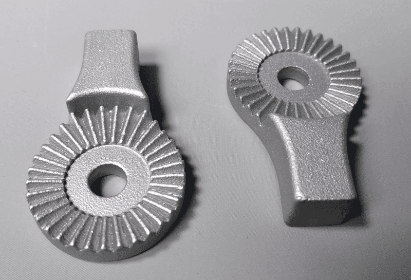

Do you need the mechanism to be infinitely adjustable in angle? Or can you have it lock every 10 degrees or so? You can get a much stronger locking mechanism if you can use a gear-faces as locking surfaces ("Hirth Joint")...
https://www.hirth-joint.com/hirth-joint/

When you replace the flat pancake clamp with the α conical clamp, there is an advantage of 1 / Tan( α ) ;
For a cone of; α = 30°, that is a factor of 1.732
The radius of the friction surface is still; ( Ro + Ri ) / 2
With data from post #5, r = ( 30 + 40 ) / 4 = 17.5 mm.
The friction cone torque becomes = 61.42 Nm
Compared to the lever arm torque = 30.02 Nm

There is a problem with the design of your conical clamp in post #5.
You have not specified which surfaces slide and which are keyed.
