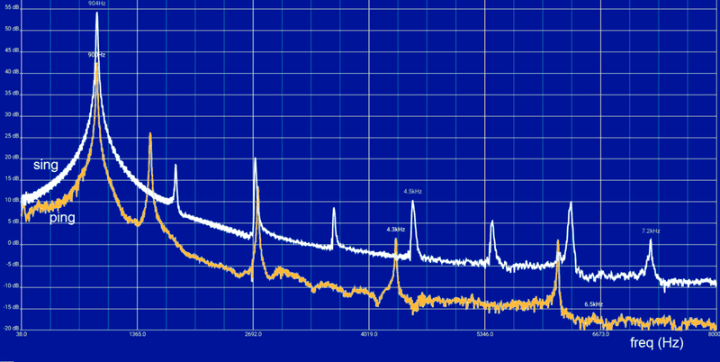

I recorded the sound spectra of a singing wineglass (rubbed the rim with a wet finger) and a pinging wineglass (tapped anywhere at its wall) with a smartphone. Evidently the fundamental tones of both vibrations are identical, but the overtones are very different (harmonic vs. anharmonic). As the fundamental tones are identical it seems fair to assume that the singing and the pinging vibrations have a lot in common. Then why is pinging unable to excite the singing-overtones, and vice versa?

I notice that for "singing", every harmonic is present. This seems correct for flexural vibration of a ring. It is similar to the electrical resonance of a metal ring, where the lowest frequency corresponds to one wavelength circumference. On the other hand, the striking method has only odd harmonics, so it looks as if an antinode is forced on the system, like a shorted transmission line. But the fundamental frequencies are similar in both cases, so I am thinking that the vibrations in the two cases have different modes.

The harmonic singing overtones persist for a second or so (the fundamental tone lasts longer), so my finger is required for the creation of the singing overtones, but not for their persistence.
Remarkably, pinging overtones grow during the first second after hitting the glass.

Flexural vibrations are dispersive, high frequency waves travel faster. In a straight bar the velocity is proportional to the square root of the frequency. As a result the overtones of a straight bar would be proportional to n2. The pinging overtone frequencies of the wineglass are not odd harmonics, they are approximately proportional to n2. The harmonic spectrum of the singing overtones is harder to explain.
