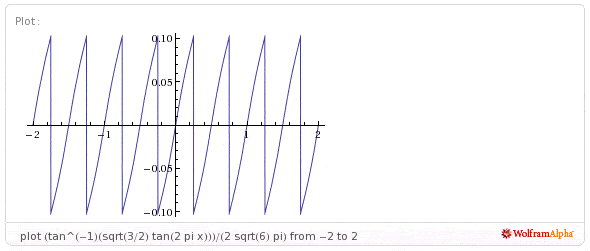

Look at a graph of the function that's given as the anti-derivative. It's discontinuous (with jump discontinuities) on the interval over which you are integrating.
Here is what WolframAlpha shows.

Maple gives exactly the same thing (with slightly different ways of writing equivalent results). If you plot the antiderivative function F(x) as given by Mathematica or Maple, you will see it has jump discontinuities at x = 1/4 and x = 3/4. You could have a *continuous* antiderivative by essentially adding the jump discontinuity to the formula in (1/4,3/4) and once again in (3/4,1). Basically, this amounts to changing the constant of integration as you pass through x = 1/4 and again as you pass through x = 3/4. For that continuous antiderivative, Fc(x) we do, indeed, get the definite integral as the difference Fc(1)-Fc(0).
Fortunately, both Mathematica and Maple are smart enough to know they must be more careful when dealing with the definite integral. In fact, we can get Maple to give us the appropriate result using the commands J1 := int(f,x=0..t) assuming t>0,t<1/4; and J2:=int(f,x=0..t) assuming t>1/4,t<3/4. The result for t>1/4, t<3/4 has an extra term that switches on at t = 1/4 (and again at t = 3/4), to give a continuous F(t).

What Mathematica is doing is using a substitution involving the principal branch of the inverse tangent that is only valid in the range x∈(-1/4,1/4).
