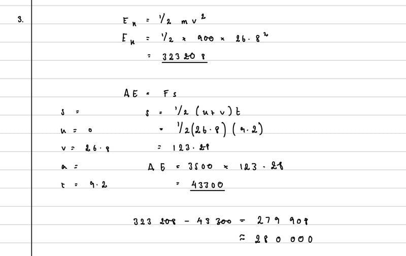

A car of mass 900kg accelerates from 0 to 26.8 m/s in 9.2 s. The thrust from the engine is constant at 3500 N during this period. By comparing the kinetic energy gained by the car with the total work done by the engine, calculate the work done against resistive forces.
suvat, kinetic energy, work done
Missed units in the photo - J
Answer is 110 000 J
g9WfI said:
Homework Statement:: A car of mass 900kg accelerates from 0 to 26.8 m/s in 9.2 s. The thrust from the engine is constant at 3500 N during this period. By comparing the kinetic energy gained by the car with the total work done by the engine, calculate the work done against resistive forces.
Relevant Equations:: suvat, kinetic energy, work done
Answer is 110 000 J
3500 * 123.48 = 431480, not 43300
