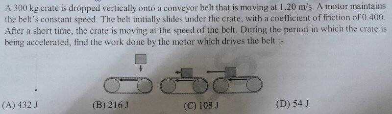

A 300kg crate is dropped vertically onto a conveyer belt moving at constant speed of 1.20m/s under the action of motor. If coefficient of kinetic friction is 0.400 find work done my the motor.
NA
The question was this:
Four-part diagram of a conveyor belt with a crate: a crate dropped onto the belt, then the crate sliding with arrows showing belt and crate motion, with answer options (A) 432 J, (B) 216 J, (C) 108 J, (D) 54 J.
My calculations show that the answer should be equal to work done on crate to make it reach the same velocity which is equal to 216 J but the answer given is 432 J
It is believed that extra energy is needed to overcome friction but friction is an internal force and there is no mention of heat loss so work done should be independent of friction.
Also if extra energy was needed to overcome friction between belt and crate, it should also mean that the work done in pushing two blocks of metal placed on each other would be more than that of a single block made by melting both which is not true?
Please Explain 🙏
Thank You

The other half the work was expended against friction.
In reaching the belt speed, v, the crate had an average speed of v/2. So the belt has travelled twice as far against the frictional force as the crate has been pushed by it.
The motor has to expend its effort against a belt which is always moving at full speed. The belt is expending its effort against a box which is moving on average at half that speed. First slow, then fast.
The motor exerts its force over twice the displacement.

When the box comes into initial contact with the belt, the box's x-component of velocity is zero. The box then gets accelerated in the x-direction, by friction for some time T. After T, the box's velocity is the same as the belt's.
During T, there is sliding between the belt and the box - heat will unavoidably be produced by friction. (This energy will increase the temperature of the surfaces and eventually be lost to the environment.)
The heat generated by friction turns out to be 216J. So the total energy (kinetic + heat) required to get the box up to speed is 216J+216J = 432J.

Equivalent Problem:
I attach a battery (voltageV) to a capacitor C which delivers a charge Q=CV to the cap.
Energy supplied by the battery=VQ=CV2
Enerrgy stored in the cap= CV2/2
Same reasons
