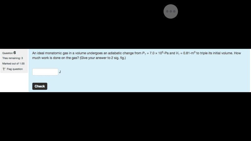

1. The problem statement, all variables and given/known data
Online homework screenshot, Question 6: ideal monatomic gas adiabatic change from P1 = 7.0 x 10^5 Pa and V1 = 0.81 m^3 with volume tripled; asks work done on gas to 2 sig. fig., answer in J, with Check button.

  • Online homework screenshot: Question 6 text reads: An ideal monatomic gas in a volume undergoes an adiabatic change from P1 = 7.0 × 10^5 Pa and V1 = 0.81 m^3 to triple its initial volume. How much work is done on the gas? (Give your answer to 2 sig. fig.), with an empty answer box labelled J and a Check button.
