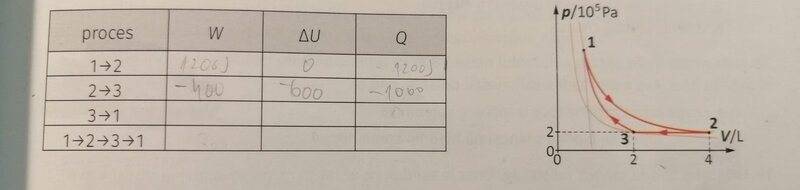

How to calculate work in cycle process that consists of isothermal, isobaric and adiabatic processes.
deltaU=Q-W, Q=W, Q=-W,
(picture of diagram below)So the task goes like this: gas is ideal. Process 3->1 s adiabatic and in process 1->2 work done is 1200J. Fill the table.
I don't know how to calculate work done in an adiabatic process because p2 and V2 are not given and I don't know gama(Cp/Cv).
I know that deltaU of the entire process is 0. So if I am thinking correctly work done should be 800J because work done from 2->3 is -400J(first two processes are correct) and that is energy gained back, so to reach 1200J of work we need 800J more, but it's not. Apparently work done in 3->1 is -600J, deltaU= 600J and Q=0. And total work done is 200J, deltaU=0, and Q= 200J.
Please help me.

P.S. the line between 0 and 2 is my handiwork. It's not given by authors so I don't think I should use it.
OK. But you should show or explain how you got this.
How did you get ##\Delta U = -600## J and ##Q = -1000## J for process 2 -> 3?
Well process is isobaric so W=pdeltaV, and deltaU = U2 - U1. U2= 3/2p2V2, U1=3/2p1V1. Q=deltaU+W

If the gas is given to be monatomic, then I agree with your results for processes 1 -> 2 and 2 -> 3.
Here, it appears to me that you believe that the total work done for the three individual processes should add to zero. That would make the total work done for the cycle equal to zero. But, that isn't true. (The work done for the cycle equals the area enclosed by the cycle on the PV diagram.) But maybe I'm misinterpreting what you are saying. Anyway, I'm not following your reasoning here.

No, deltaU=0, work done by the cycle should equal heat received + energy from work in process 2->3. But I can't calculate deltaU for adiabatic process or work done by adiabatic process. That + work done from 2->3 would equal the heat recieved by the system to do work of 1200J. Right? Or I got something wrong?
You need to be systematic and fill in the Table with the appropriate entries. Start by finding the temperatures at the three points. You ##V_3## and ##p_3##, so you can find ##T_3##. Knowing that and the adiabatic condition, you can find ##T_1## and hence ##T_2##. Once you have the temperatures, you can fill in the ##\Delta U## entries. Then come the works and heats at each leg of the cycle. Unless the problem states otherwise, I would assume that the gas is monatomic so that ##C_V=\frac{3}{2}R##.
When the Table is completely filled, you can check your work for consistency. The sum of the ##\Delta U## entries must be zero and the the sum of all the ##Q## entries must be the negative of the sum of all the ##W## entries. Furthermore, the ##\Delta U## in each row must be equal to ##Q-W## in that row.

Suppose you let ##x## represent the unknown amount of work done in the adiabatic process 3 -> 1. Can you fill in the table for 3 -> 1 in terms of ##x##?
ohh yess. I completely forgot about that. Thank you @kuruman

You can calculate all the Table entries individually and use the first law to check your work. As I indicated earlier, you start by finding the temperatures. My opinion is that in intro level thermo problems all gases are ideal and monatomic unless there is explicit information to the contrary. This means that ##C_V=\frac{3}{2}R## and ##C_p=\frac{5}{2}R##. Here is what I recommend.
1. Start with ##T_3## because you know ##p_3## and ##V_3##. Then finding ##T_2## is easy and finding ##T_1## is trivial. This will pave the way for finding the three ##\Delta U## entries assuming that the gas is monatomic.
2. Find the work done by the gas during each process. You will need to derive expressions for the adiabatic and isothermal legs if you don't remember them.
3. Find the heat entering the gas for each process. You know that ##Q=0## for the adiabatic and ##Q=W## for the isothermal. What is the relevant equation for the heat entering the gas at constant pressure?
When you complete the above 3 steps, you're done.

That bothers me too. However, for this particular problem, you don't need ##C_V## and ##C_p## if you use the first law after you find all the ##\Delta U## entries. You can determine the ##Q## and ##W## entries by demanding that the first law be satisfied to find what's missing. However, I don't think that this is instructive. That is why I suggested that you find the entries independently and verify that the fist law is satisfied during each step.
