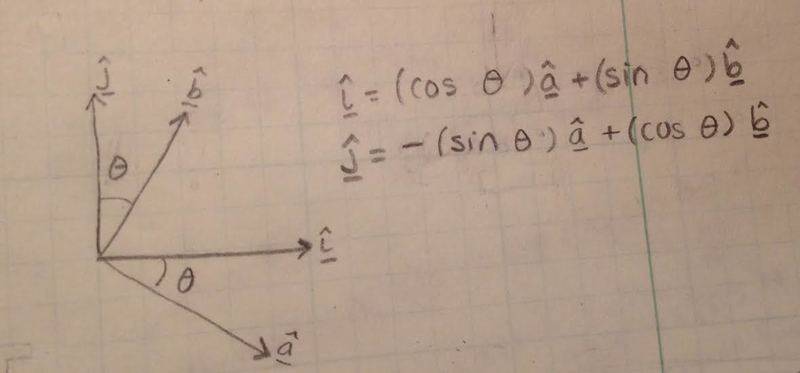

The numbers are good, I just checked them! Looking at the prompt again, it says to ignore the b component of the wind force (the component perpendicular to the ramp). So would the sum of the nonconservative forces be (Fw)a + f (the a component of the wind force and the friction force)? (Essentially, the sum of the forces in the a direction--the direction parallel to the ramp)?
Also, is this a correct conversion from x-y to a-b coordinates, given the two relative coordinate systems?
Ah, right.
All your forces are conservative here.
Wind just adds another force to consider, noting magical.
The conversion looks fine.
