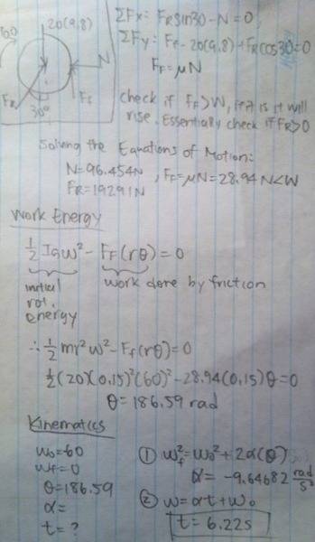

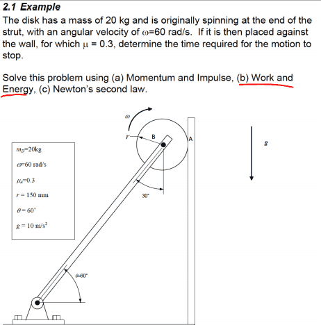

Using work energy theorem, solve:
The actual answer (3.11s) is exactly half of my answer. Does anyone know what I did wrong?
Note that moment of inertia of a uniform disc about an axis through its centre and perpendicular to its plane is
[itex]\frac{1}{2}[/itex]MR[itex]^{2}[/itex].
Yup! That is what I used I believe.
There should be two factors of 1/2 - one from Iω2/2 for the KE and another from I=Mr2/2.
