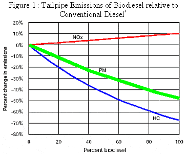

EDIT: Some good info about biodiesel,
http://www.ucsusa.org/clean_vehicles/technologies_and_fuels/biofuels/biodiesel-basics.html#Biodiesel_versus_gasoline_in_cars_and_li
Note that only the limit of your graph shows the results for pure biodiesel.
Biodiesel is notoriously low in emissions, less NOX emission, which are a bit higher than petrodiesel. Beyond that, the emissions from any particular biodiesel fuel depends on the source of the fuel. Oils low in saturated fats, like oils from algae, produce the cleanest fuels. Being high in saturated fats, soy produces a relatively unclean biodiesel, which is what most studies would have used.
There are two factors to consider regarding the energy content of petrodiesel. First is the amount of energy contained in a gallon of fuel. While this tracks approximately 1:1 with the amount of crude required, we transport ~25% less fuel to the market for a given amount of energy. Beyond the reduced distribution energy costs, diesel engines are more efficient than IC engines.

Not true. Biodiesel is in common use now.
I did not know this. Where is it being used?
Biodiesel is notoriously low in emissions, less NOx emission, which are a bit higher than petrodiesel.
Yes, but keep in mind that NOx emissions are one of the most harmful emissions created. The idea behind a closed CO2 cycle is appealing but you can't ignore the other harmful products that are generated as well.
