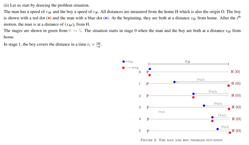

Using the ##\text{wrapfig}## package, the text appears below and above the figure, but not alongside it.
I am new to ##\rm{LaTeX}##.
Using the ##\texttt{wrapfig}## package, the figure loads correctly to the right.
However, the text, though I typed much of it below where I specified the image to be, comes above it, not alongside it.
I cope and paste my code below. You will see much the text that appear above the figure are actually written below it. I was hoping the text will appear alongside it, in the white empty space to the left.

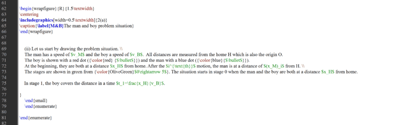

I am using ##\texttt{TexMaker}##. The figure is defined above from lines 62-66. The text comes below from lines 69-75. This text is meant to wrap around the image, but it doesn't, as you saw in the previous picture.
Request : Where have I gone wrong?
Why is your wrapfigure 1.5\textwidth?
Also, please don’t post code as images. Use the code tags.

So that the figure goes to the very right of the page. [r] or [R} is not doing it. 0.5 textwidth takes it to the middle.
[CODE title="\LaTeX Code" highlight="7-11, 14"]\textbf{Solution}
\begin{enumerate} [leftmargin=0pt] %
\begin{small}
{\fontfamily{ptm}\selectfont
\item (i) It's easy to do it using the method of distance-time. We note that the boy will only run for as long as his father walks. His father will walk home for a time of $t=\frac{x_H}{v_M}$, where $x_H, v_M$ are the distance to home and the man's walking speed, respectively. Hence, the boy covers a total distance of $s_B=\frac{v_B}{v_M}x_H= \frac{12}{4}\times 1.2 = 3.6$ km. \\
\begin{wrapfigure}{R}{1.5\textwidth}
\centering
\includegraphics[width=0.5\textwidth]{2(a)}
\caption{\label{M&B}The man and boy problem situation}
\end{wrapfigure}
(ii) Let us start by drawing the problem situation. \\
The man has a speed of $v_M$ and the boy a speed of $v_B$. All distances are measured from the home H which is also the origin O.
The boy is shown with a red dot ({\color{red} {$\bullet$}}) and the man with a blue dot ({\color{blue}{$\bullet$}}).
At the beginning, they are both at a distance $x_H$ from home. After the $i^{\text{th}}$ motion, the man is at a distance of $(x_M)_i$ from H. \\
The stages are shown in green from $\mathbf{\color{OliveGreen}{0\rightarrow 5}}$. The situation starts in stage 0 when the man and the boy are both at a distance $x_H$ from home.
In stage 1, the boy covers the distance in a time $t_1=\frac{x_H}{v_B}$.
\end{small}
\end{enumerate}[/CODE]
