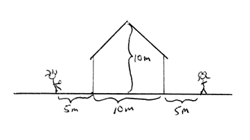

You’re 5.00 m from the left-hand wall of the house shown in the drawing, and you want to throw a ball to a friend 5.00 m from the right-hand wall. You throw the ball so that at the peak of its trajectory it just clears the top of the roof
Side-view sketch of a house with a 10 m tall wall, a stick figure 5 m to the left of the left wall and another 5 m to the right of the right wall, with the 10 m house width marked below.
a. What was the y-component of the initial velocity?
b. What was the x-component of the initial velocity?Not sure how to go about this problem since it doesn't tell me anything other than the distances, no angles or velocities, any help would be great.

The angle is ##\alpha##, the initial velocity is ##v##. Now you can use both to set up your equations.
You'll be able to calculate numbers for those two quantities later.
Simply introducing variables for unknown quantities is a very useful technique in many problems.

You know the vertical height = 10 m and with a value for g, you can figure the vertical component of the launch velocity and the time taken to reach the zenith (top of the roof)
With the time you can figure the (constant) horizontal velocity required.
Here's what I came up with so far. I know sin of the angle = Vy/V and cos of the angle = Vx/V. Then do some algebra to get Vy = Vsin of angle and Vx=Vcos of angle. But since It doesn't list a velocity in the problem, how are you actually suspose to get a value for the x and y components of the initial velocity? Or can you with the given data? Would it just have to be a sort of equation like I figured out before? Can somebody please tell me the answer to this and explain it to me, because all I've gotten now are just very vague points about how i should look back at this and that, an answer is the only thing that would help me actually understand this problem. Thank you!
How fast do you need to throw the ball for it to go 10 meters up with an acceleration of g?
