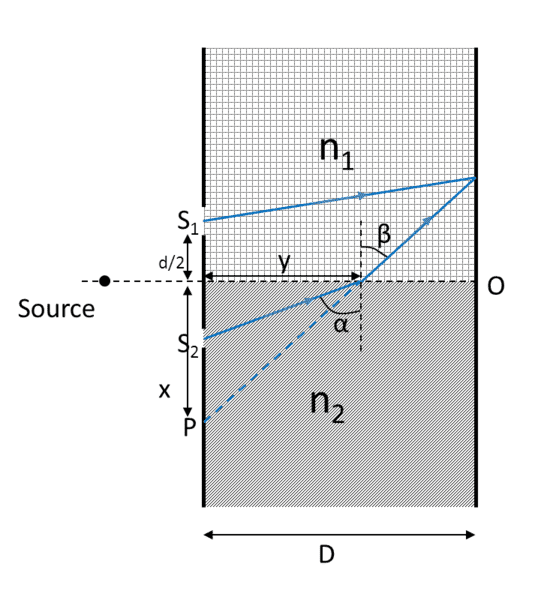

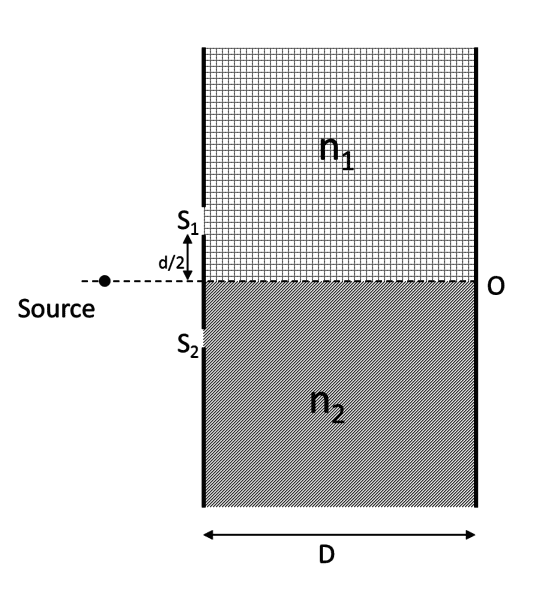

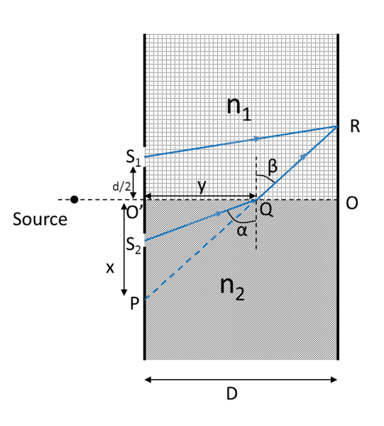

Consider the scheme of YDSE as shown in fig filled with transparent of refractive indices ##n_1## and ##n_2## respectively.The slits are at a distance d apart. Find:
1. Location and width of central maxima.
2. Condition for constructive and destructive inteference
3. Fringe width above and below O.
I have never encountered such kind of setup for YDSE so I am not sure if the following is correct.
Consider the rays shown in attachment 2. I am thinking that if the refracted ray is extended backwards, it meets the cardboard with slits at point P. I can consider point P as the "effective" second slit. So I need the distance between the slit ##S_1## and this point i.e (x+d/2).
From Snell's law and trigonometry, I found ##x=\frac{n_1d}{2n_2}##. Hence, the central maxima would lie on the perpendicular bisector of line joining ##S_1## and P i.e at a distance of ##d/4(1+n_1/n_2)##. The central maxima is at distance ##(d/4)(1-n_1/n_2)## from O. Is this correct?
Any help is appreciated. Thanks!

The effect of the media is to change the effective path length... there have been treatments of this:
http://www.physics.ohio-state.edu/~gohlke/pedagogy/Phys133I_Diffraction.pdf
... just puts a glass slide after one slit.
Which is more usual.
For the case that the media goes all the way to the screen - say a glass block on one side and some liquid on the other - you still need the whole path, because the phase at P is also important and P is also in different places for different positions along the screen. i.e. you cannot treat point P as an effective "other slit".
Hi Simon Bridge! :)
Simon Bridge said:
...and P is also in different places for different positions along the screen.
I am not sure if I agree with this but the value of ##x## comes out to be the same irrespective of the position on the screen. :confused:
OK, so let's label a few more bits of your diagram so I can talk about them:
Let the point of refraction be ##Q## and the point on the screen be ##R##, the distance ##|OR|=z##.
sanity check:
for ##d<<D##, ##\alpha \simeq \pi/2##, which makes ##\beta \simeq \sin^{-1}\frac{n_2}{n_1}##
... which fixes the value of ##\beta## to a narrow range of possible angles: approximately constant.
Given constant ##\beta##, the position of R will determine the position of Q and P.
You can check this with a straight edge.
[edited for brevity]
Sorry for the delay in reply. :redface:
I am in full agreement that position of Q depends on position of R but I don't see how the position of P gets affected. Can you please show me what's wrong with the calculations I have done in my attempt? Please tell me if anything is unclear in my attempt, I will post the steps for how I arrived at ##x##.
Maybe I misunderstood: on your diagram, P Q and R are on the same line. You can demonstrate the dependence of P on R by using a straight edge - same slope (because β is a constant), different values of R. Or you can keep P fixed, change R, and notice that the angle β has to change quite a lot to accommodate this, which it cannot do if D>>d. Unless you see something I missed ;)
You have not shown your working so I cannot, besides, it is not my practice to check someone else's working for them - however:
You have concluded that: ##x=\frac{n_1d}{2n_2}##
... which looks the same as saying that ##\frac{d}{2}=x\sin\beta##
... does this make sense geometrically?
I don't see how you got from the diagram you provided to this relation.
(BTW: we may want to label the point half way between S1 and S2 as O' or something.)
... never mind - I think I see.
I'll get back to you.
[edit: back - I have a feeling about what you did but I would like you to show me before I make wild guesses.]

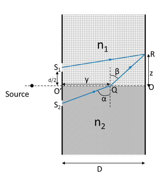

I post my working. :)
I have marked Q as the point of refraction and O' as the point lying exactly midway between ##S_1## and ##S_2##.
In ##\Delta S_2O'Q##,
$$\tan(\pi/2-\alpha)=\frac{d/2}{y}=\cot\alpha=\frac{1}{\tan\alpha}$$
Since the angles are small, I can write ##\tan\alpha \approx \alpha## i.e
$$\frac{1}{\alpha}=\frac{d}{2y}\Rightarrow \alpha=\frac{2y}{d}\,\,\,\, (*)$$
From Snell's law: ##n_2\sin\alpha=n_1\sin\beta \Rightarrow n_2\alpha=n_1\beta \Rightarrow \beta=(n_2/n_1)\alpha##
In ##\Delta PO'Q##,
$$\tan(\pi/2-\beta)=\frac{x}{y}=\frac{1}{\tan\beta}$$
Again ##\tan\beta \approx \beta##, i.e
$$\frac{1}{\beta}=\frac{x}{y} \Rightarrow \beta=\frac{y}{x} \Rightarrow \frac{n_2}{n_1}\alpha=\frac{y}{x}\,\,\, (**)$$
Dividing (*) and (**), I get
$$\frac{\alpha}{(n_2/n_1)\alpha}=\frac{2y/d}{y/x}\Rightarrow \frac{n_1}{n_2}=\frac{2x}{d} \Rightarrow x=\frac{n_1}{n_2}\frac{d}{2}$$
...which is the same relation I posted in my attempt.
Please let me know if anything is still unclear.

Hi Pranav, in your derivation you have assumed α is very small. If α is the angle made by the incident ray with the normal, it will be small only when y is very small. In that case the screen should be very close the the slits.
Hi rl.bhat! :)
Ah yes, I see it now, Simon Bridge pointed this out as ##\alpha \approx \pi/2##, I should have been careful. :redface:
But now how should I approach this problem? :confused:
That was the feeling I had - I could only get your result by assuming that ##\tan\alpha \approx \sin\alpha## etc. The "small angles" approximation for D>>d is for the angle θ=∠RO'O.
The impact of D>>d on α and β is that ##\beta = \sin^{-1}(\frac{n_2}{n_1})## ... as per post #4.
Approach:
Use the phasor description - work out the phase of the ray from S1 and S2 as a function of z.
The amplitude at R will be proportional to the vector sum of the two phasors.
There is a reason you don't find this case discussed much online: it is not easy.

Simon Bridge said:
Approach:
I am not sure but do I have to work out the path difference? :confused:
$$\Delta x=n_1(S_1R-QR)-n_2S_2Q$$
where ##\Delta x## is the path difference.
$$S_1R=\sqrt{\left(z-\frac{d}{2}\right)^2+D^2}$$
$$\sin\left(\frac{\pi}{2}-\beta\right)=\frac{z}{QR}\Rightarrow QR=\frac{z}{\cos\beta}=\frac{n_1z}{\sqrt{n_1^2-n_2^2}}$$
$$S_2Q \approx O'Q=D-QO=D-z\tan\beta=D-\frac{zn_2}{\sqrt{n_1^2-n_2^2}}$$
I think I need to approximate ##S_1R## but how? :confused:
  • Geometry diagram of a two-slit setup with a source on the left, slits S1 and S2, regions n1 above and n2 below a horizontal interface, a refracted ray meeting it at point Q, and a point R on the screen at height z, with labelled width D, offset y, and angles alpha and beta.
Keeping to the same labels as before:
You want to divide the screen into two areas - z>0 and z<0.
You are currently working for z>0
iirc: the optical path difference (OPD) should be a whole number of vacuum wavelengths.
http://www.physics.gla.ac.uk/~johannes/optics_lecture/overheads11_2_2_6-8.pdf
http://www.ph.utexas.edu/~asimha/PHY315/OpticalPathLength.pdf
Did you notice: $$\frac{D-y}{\sqrt{(D-y)^2+z^2}}\simeq \frac{n_2}{n_1}$$
Note: in the regular setup, you get to exploit ##\theta_1=\theta_2=\theta## for D>>d, and ##D\tan\theta=z##.
In this case ##\theta_1 = \theta \neq \theta_2##
So you may get away with approximating ##|S_1R|=\sqrt{z^2+D^2}##.
I don't really know, I havn't done it.
You will have a lot of messing about before you hit one something useful.
Try working it out without the approximations to get a very messy ##\Delta\phi = f(z):z>0##, then plot phase-change vs z for some handy values. See what happens.
note: $$\frac{1}{\tan\beta} = \sqrt{\left(\frac{n_1}{n_2}\right)^2-1}$$ ... this number appears a LOT and it is a constant for the setup - so maybe give it it's own letter?
