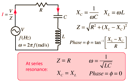

The impedance of the circuit shown is:
A. 41.1 Ω
B. 100 Ω
C. 173 Ω
D. 187 Ω
E. 241 Ω
Z= sqrt (R^2 + [Xinduct - Xcapac]^2)
Wd = 1/sqrt(L * C)
Xinduct = WdL
Xcapac = 1/WdC
I think my issues come with the 2nd to 4th equations.
The answer I get is 100 ohms, which i get as wrong, I follow the below logic
Wd = 1/sqrt (0.0002*0.5)
Wd=100
Xinduct = 0.02
Xcapac = 0.02
thus Z = R which is 100 ohms.
Where have I gone wrong here?
Hi Jimbo,
You want to work with the complex impedance, because there is a phase involved.
So ##Z_L = j\omega L ## and ##Z_C = {1\over j\omega C}##.
Are you comfortable with that approach ?
BvU said:
Hi Jimbo,
Is Jw here the same as the angular frequency wd?
The textbook chapter that this refers to says nothing about complex impedance as opposed to regular impedance, so I am not sure I get what you mean?
##\omega## is the angular frequency allright, but not the LC resonance frequency ##\omega_r## (*)
It is the driving frequency in the circuit under consideration, so in this case ##50 \times 2\pi = 100 \pi ## rad/s.
(*) your wd, for which ##\ |Z_{LC}| = 0\ ## from $$\ j\omega L + {1\over j\omega C} = j\omega L\; \left ( 1 + {1\over j^2\omega^2 LC }\right ) = j\omega L\; \left ( 1 - {1\over \omega^2 LC }\right )\ = 0 $$ if ## \omega^2 LC = 1##, a frequency of ##100/2\pi## Hz.
I have a feeling this picture tells me all I need?
w = 2pi *50
Xc = 15.92
XL = 157.08
Thus Z = 173, thus C.
Is that correct reasoning?
Yes. But now I am afraid you have no idea where the ##X_L - X_C## comes from ...
