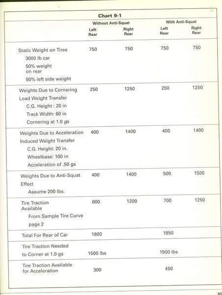

When straight line braking , such as in road racing whatstops wheel hop or rear wheel lock up without dialing all front brake in. is there any rear measurements that can be adjusted to stop so much weight transfer to the front when braking , or be able to make the whole car lower during braking
SMOKIN
  • #334
i am in germany this week..will reply when i get back,,,thanks for the interest
rm
  • #335
smokin..
some notes on wheel hop
you said When straight line braking , such as in road racing whatstops wheel hop or rear wheel lock up without dialing all front brake in.
Rear wheel hop is basically the suspension gets into a resonant situation and doesn't dampen itself out.
Under acceleration, the rear suspension compresses. Due to inertia, the wheel continues traveling upward. This unloads the tire, reducing the acceleration force. The spring then pushes back down on the wheel, and it regains traction, forcing the wheel back up.
Play and movement in suspension arms can exaggerate the problem.
The best way to fix it depends on the vehicle. Vehicles suspension can be designed with "anti-squat" capabilities, but at the expense of ride quality. 4 link cars with solid rear axles can use "no hop" bars to change the suspension geometry.
Angle of upper link on rear end will effect wheel hop. A large amount of anti squat ( down hill angel of top link) will cause rear end lightness and rear wheel hop under braking. The 3rd link shock will effect it as well.
Shocks, shocks shocks..check the shocks...stiffer shocks will help.
Leaf spring cars can use traction bars to eliminate it.
Stiffer ARB ( sway bar). Softer rear spring package. Need to keep more weight on rear end.
Also, test the car with a light fuel load because the weight difference (sometimes in the neighborhood of 150 pounds) can affect wheel hop as well. Wheel hop is less likely on production-based sports cars with an independent rear suspension because the center- section of the axle is hung by the chassis, but it can still occur especially if an unskilled driver is punching the brakes and shifting the gears

  • #342
Mike, a stiffer sway bar won't affect longitudinal weight transfer, and a softer rear spring will allow more rear end lift than a stiff spring. Weight transfer caused by chassis/suspension movement is the only component of the total weight transfer that can be altered with adjustments; the weight transfer due to decel force is determined by the C of G height and is built into the car.
Dialing in more anti-squat will tend to pull the rear of the car down during braking but that usually unloads the tires and can also result in wheel hop.
  • #343
Mender, i may have not understood your post ref: sway bar...I always thought the ARB was 1/3 of the proper handling package ( see post 19 on page two above)..
I am with you on the anti squat dial in..but after looking back thru this forum, we never discussed Anti Roll Bar ( sway bars ) and will work on post to do this.
  • #344
Mike, I was answering in the context of:
"When straight line braking , such as in road racing ..."
When there is no cornering involved the ARB just rotates in the bushings so it has no effect.
  • #345
Mender..you are correct...the ARB would have little to no effect on straight line braking..which I never think about unless the car is coming into the pits...excellent advice!
thanks

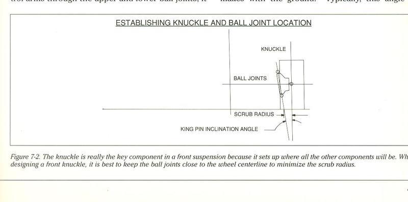

I have to say, I never knew there were so many things to consider when building a oval track car... lol
It seemed so much easier 15 years ago when I last raced and we weren't supposed to move anything...
So I'm wondering the consequences of less than ideal scrub radius?
To widen the stance of the car (chevelle) the previous owner was using 8" wheels with 1-1/2" back spacing... I have yet to run the numbers... hmmm...
What should I be looking for in scrub radius with 8" wheels? What if I can't get it witout sacrificing track width?
Thanx!
  • #347
Hey Mender..i am working on ARB post but I been rebuilding the old NAA Ford tractor. Dandelions don't wait on anyone!
Hey Rick...glad to hear from you..I think if you review post 264 and 255 on page 17 about track width...and then post 325 on page 21 about scrub radius..good info..personally scrub radius is drivers choice..
depending on feel if car is too darty or grabby..
me being a non driver and selfish crew chief interested in WINS..screw the driver feel and feed back and make it as wide as you can get away with...
  • #348
So scrub radius has no adverse affect on grip That's good to know...
  • #349

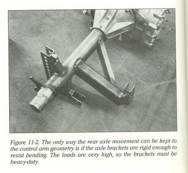

Timaladd..welcome,,good to have new racer.. i grew up on these set ups..even had torsion bar front end..
see post 116 on page 8 for roll steer explanation
Hotchkiss drive rear suspensions
NO rubber bushings belong in any race car chassis set up.Get nylon or urethane or brass bushings but get rid of the rubber stuff.
Been around since horse and buggy days but it is simple and it works. it was found that mounting one shock ahead of the axle and the other behind would reduce torque induced wheel hop during acceleration and braking.
Since the leaf spring is used to transmit acceleration and braking forces, their positioning and configuration is critical. These forces cause the axle to twist and tend to wrap up and distort. To counter this it is necessary to increase the number of spring leafs or thickness of the leaf to get enough force to counter spring wrap. You can add a full leaf or thicker leaf but this also increases spring rate. It was found that if only the front half of the spring leaf is added, axle wrap is decreased while not adding as much spring rate as a full leaf.
Spring eye height of the front spring eye primarily determines how much anti-squat the rear suspension will have. The higher the spring eye the more anti - squat. Generally height between 10 and 15 inch above ground give best results. If you run the spring eye too high you will get brake hop. The rear spring eye also effects anti-squat but not as much.
To work properly, mono leaf springs must be mounted straight and parallel to each other and perpendicular to the axle housing.
The rear Roll Center (RC) on mono leaf setup is located half way between the bottom of the rear end housing tube and the top of the leaf spring.The Rc can be changed slightly by using shorter or taller lowering blocks. Don't go over 2.5 inch because a taller block will create too much leverage on the leaf spring and really adds deformation under acceleration/braking.
Cars with monoleaf springs usually have rear RC at 8.5 to 11 inch. These leaf systems are not as tuneable as Coils/ coil over shock packages. The only way to change rear RC is to move ballast weight around. On a dry slick track mounting ballast higher in the chassis will create more overturning moment which creates more right rear side bite. Typical monoleafs come in .323, .291 and .262 inch thickness. Thinner springs work better on dry slick tracks because they deform and cushion wheel spin better. But this weakens the springs and you must monitor the leafs for deformation. Thicker leaf will last longer but not provide optimum hook up. The .291 inch leaf is best compromise but..you need to replace these at least once a season.
NOTE: The springs must always remain parallel to each other in the fore/aft plane. In other words.. Don't locate the right side spring eye in the top chassis spring eye hole and the left front spring eye in the bottom front spring eye hole. Move them the same and together.
Use slider boxes to mount the rear spring eyes. They eliminate spring bind cause by shackle distortion. The mounting angle determines the amount of roll steer you will have. The best way to amount a leaf spring is with slight downward angle, as viewed from the side, with the front eye of the spring slightly lower then the rear spring eye. The downward angle should be 2 to 4 degrees.
Arch of the leaf and amount of torque warp in the leaf determines the amount of rear roll steer. When cornering, the more arch in each spring will mean more roll steer. The right rear spring compresses and lengthens. The left rear unloads and shortens up. The right rear is lengthened creating rear over steer. The amount of roll oversteer depends on the spring arch and amount of body roll. Three inches of arch usually produce a fair amount of roll over steer. One inch is probably not enough.
When you nail it out of the turn, the torque wraps the front spring and shortens the front segment and pulls the axle tube forward. This depends on the arch and thickness. One last note; see the post # 298 on page 19, on eccentric for right side front spring eye. hope this helps.
