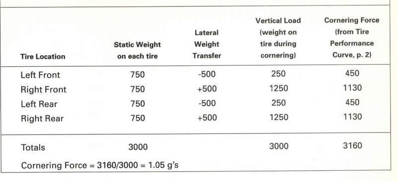

is wider tire better
like everything in racing , its all about compromise..we went thru this mind drill in FC ( Formula Continental) a few years back. In a class that races open wheel and limited horsepower the traction benefits of wider boots on all four corners may not be worth is. The key factor is engine output ( torque and HP). Open wheel cars get killed with big aero drag and tires account for at least 40% of total drag.
If.. and this is a big if the tire and wheel combination is the same as your current combination, and yoor wheels are under the car not hanging out in the air stream..Id run them. But if they are heavier than the current set up (come on...it takes more metal to make them... more metal = more weight). There's also more rolling mass. More rolling mass = slower rotation = slower speed. Figure about 2% more grip per inch tire width you add,,,but,,,parasitic drag is a BEAR...esp in open wheel limited hp racing.
see post below on General Physics forum,

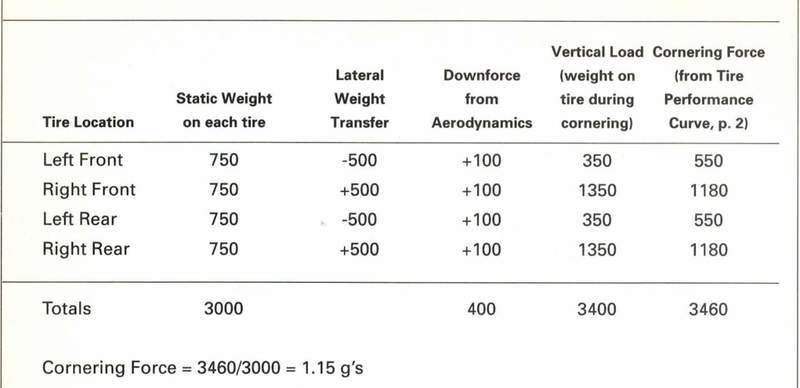

look at illustration on post 255 @ page 16...note the cornering Gs increase with 4 inch wider track..
thats a lot of weight but...if you need it to be legal...what size battery are you using?
