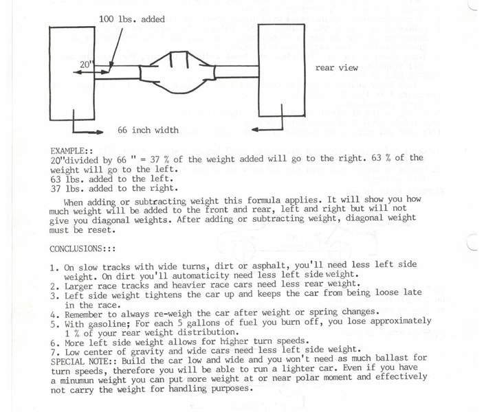

General Rule of thumb - 1 inch lower COG transfers 3 to 4 % less weight. 1 inch wider car transfers 1 to 1 1/2 % less weight.
Assume we have a race car with 66 inch wide rear track and we add 100 weight to the ballast and we locate this weight 20 inch from the center line of the left rear tire. 20" divided by 66" = 37% of the added weight will go to the right and 63 % will go to the left side of the car ( diagonal weight is not in this calculation). Now if we increase the track width on t he left side by one inch we have 21" divided by 67" = 31% right side weight and 68 % left side weight. (from Short track chassis set up by Duke Southard)
