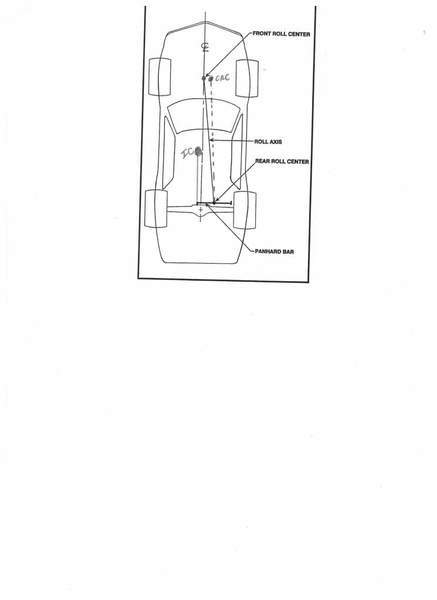

we went thru this on page 26 of this forum with a fellow running a drawf car...wider is better in that you have more cornering ability in that for a given set up you will transfer less weight and the tires can better accommodate the weight that is transferred. Also the Left rear to right front leverage is improved slightly...and thus side bite off the turn with a tad more wedge..read the whole page as we had a good debate on this...
General Rule of thumb - 1 inch lower COG transfers 3 to 4 % less weight. 1 inch wider car transfers 1 to 1 1/2 % less weight.
Assume we have a race car with 66 inch wide rear track and we add 100 weight to the ballast and we locate this weight 20 inch from the center line of the left rear tire. 20" divided by 66" = 37% of the added weight will go to the right and 63 % will go to the left side of the car ( diagonal weight is not in this calculation). Now if we increase the track width on t he left side by one inch we have 21" divided by 67" = 31% right side weight and 68 % left side weight. (from Short track chassis set up by Duke Southard)

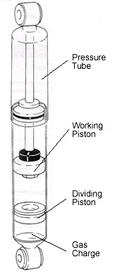

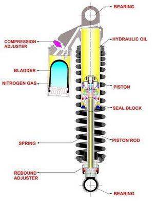

The purpose of a shock is to dampen the kinetic energy stored in the spring during weight transfer. Specifically the shock converts this vertical energy to heat energy by creating resistance to movement within the shock. Shocks control the RATE of weight transferred during cornering. Shocks have nothing to do with the amount of weight transferred during cornering. They can affect how quickly the weight is transferred. So using shocks dampening to control weight transfer is not exactly correct. Using the dampening to control the RATE of weight transfer is correct.
The amount of weight transferred is dependent on the center of gravity, roll axis and roll rates. Where the weight is transferred is dependent on the spring rates. How quickly this weight is transferred is controlled by the shocks. So Thorpe, you are a little closer to the true purpose of the shock than the other fellow..my opinion. And you are right on with the tie down scenario in that you are tuning the chassis regarding rate of transfer after you get the spring rate real close to perfect!

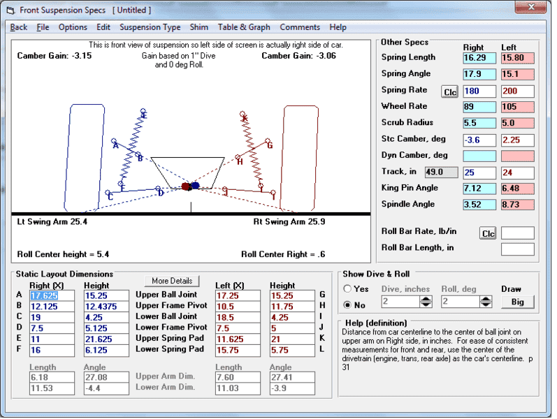

I recommend you spend the $ 100 for Roll Center software. Measure the car, find out where the Roll center is.. Next , before you do anything, look at the rules to see if you can change the roll center height, legally. As a minimum, change the Front RC location to offset it to the right to plant some down force on the right front tire. Then see if you can drop the front RC and still keep it 3 to 3.5 inch to the right. When we drop the RC we kill off camber build and the jacking effect on the right front. Rear RC should come down as well and again depends on rules and you can get different spring heights and spring rates as the software tells you.
Next work on eliminating bump steer and know your camber build curve over +/- 3 inch travel.

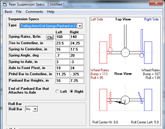

Which roll center software package do you prefer? I have been looking at the Performance trends & Auto-Ware. Both look similar but Auto-ware looks more up to date and more user friendly.
  • #519
suspension software
I use performance trends and recommend you call Kevin Gertgen, who I have worked with since 1999.

Auto Ware software is a good product from what I can see..
I think Kevin and the Performsnce Trends software is a little more advanced in that it has the higher end capabities of watching dive and roll dynamically and can use data loggers to collect the data input..plus i have many legacy programs already form over the years...
any serious racer needs at least one of these to find Roll Center and adjust accordingly

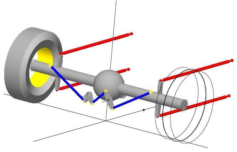

Metric chassis rear steer tips
Again many of you have messaged me on advice on gaining an advantage “ legally”.
I looked up my notes from flogging the old GM metric chassis during my door flapper days. I was into chassis measurements big time and wanted to MAP the rear end movement relative to ride height and was trying to understand what was happening when the car was in the turn.
I found that by setting the chassis on stands and mapping the rear end movement using 3 inches of right rear down and 1 inch left rear up, the metric chassis pulled the right rear tire forward almost 3/8 inch more than the left. This was AFTER I loosened the bolts holding the trail arms ..etc... as the stock serrated teeth bound up the components when “ properly tightened”. Anyway, this movement when rolling into a turn, would have the effect of tightening the car on corner exit or anytime the power was applied. I learned three things here. 1. Stock rubber bushings flex and can be to your advantage. 2. I had to free up the components to swing free when race ready and replacing the inner metal spacer that had teeth with a smaller diameter non toothed spacer was a must. Also I replaced the stock bushing bolt nuts with lock nuts at could be run down tight and then backed off a turn to prevent bind. 3. As the venerable Stroker Mcgurk once said..” If some is good and more is better then too much is just enough “ so I went on to see how much flex I could get out of the rubber bushing. More on this later.
You have to measure your car to find out where you are relative to where you want to go. If the rear axle pivots so the right-rear pulls forward, this will tighten the car. If the left rear pulls forward, the car will be looser.
Roll steer can be affected by using very soft rubber bushings. I tried the old tire softener trick but it seriously and quickly deteriorated the bushing and was a mess. With softer bushings on the right rear lower trailing arm, you have roll steer loosening the car on entry. This would reverse with the power on and tightens up the car on corner exit. The soft bushing allows the right rear wheel to pull rearward under braking. With acceleration, the right rear will push forward and this tightens the car on corner exit.
You can soften these bushings by drilling holes in them parallel to the bolt. This permits more compressibility..
Before you loosen up all your bushings, you better think about it.
If you want more roll steer to tighten up the car on corner exit you would soften the bushings on the right lower trailing arm. This compresses the wheel base on that side during acceleration by pulling the right rear forward. It would then steer to the inside. Softening the left side lower trailing arm bushings would offset much of the right side compression. This would loosen the car. Softening both might be an aid to forward traction because the rear end bottom mounting points ( trailing arms) shorten up and thus move forward in the chassis adding weight to the rear tires and more traction.
Beware- If you are using roll steer to tighten the car on corner exit, it may loosen the car on corner entry.
So why do all this...so you have an advantage over the other racer who looks at other areas for an advantage, The rules say stock trail arms and mounting locations and in some cases, no eccentric bolts...so...think about it...you could get up to 1/2 inch movement that could make all the difference.
