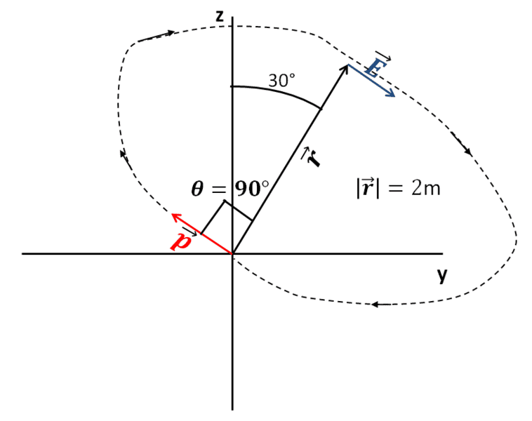

E-field at (2[m], 30⁰, 90⁰) is E = 4aѳ [V/m]. Find the magnitude and direction of the dipole moment p.
I know that I need I need to solve for the equation: p = Qd, where Q is the point charge at the given point and the distance between +Q and -Q, which should be 4[m].
The other equation I know of that may lead me in the right direction is:
E = [(Qd)/(4∏єor3)]*(2cosѳ*ar + sinѳ*aѳ).
The only thing wrong with the E equation above is that in my text it states that this equation is only valid when the point charges (+Q and -Q) are aligned with the z-axis. My question is what formula (or what variation of the formula above) do I use to determine what I need? It seems as if I need to solve for Q and d to solve for dipole moment. I know that the d vector is directed from -Q --> +Q. How would I determine the vector from this?

Looking at the electric field equation you put up, what angle will the dipole have to make with your point of interest to not have an radial vector?

Oh, I see what you're saying. Well, the radial component in my E equation is 2cos(theta)*ar. Therefore, cos(90) = 0.
Exactly, so the dipole must be at a 90 degree angle with respect to the point at which you are measuring the electric field. So once you solve for the proper angle, you will then have your dipole direction. Then all you need to worry about is the magnitude.
So if the dipole is located at the origin, the (theta) angle I need to use for the E equation is 90 degrees? I believe this is what you're saying...
Yes, the theta angle in your electric field equation will remain 90 degrees. Knowing it is 90 degrees, you get the direction of the dipole. Also, plugging it into your equation you can easily solve for the magnitude of the dipole.

There is a dipole vector, a direction vector, and an electric field vector. Let's not get confused here... To get the given electric field vector we solved that the dipole vector must be perpendicular to the direction vector. Not sure how else to explain this without drawing a picture.

No, the dipole needs to be perpendicular to the direction vector pointing to the point in space where you measure the E-field. That means the theta in the E-field equation you posted must be 90 degrees.
Lets call the dipole frame the z'-frame where it is aligned in the positive z'-axis. Since your direction vector is 30 degrees with respect to the positive z-axis, and your direction vector is 90 degrees with respect to the positive z'-axis (dipole rotated frame). Going back to the z-frame, the dipole will be -60 degrees with respect to the positive z-axis.

Unfortunately I can't explain it in better without a picture. So here is a picture I drew up to help explain it better.
The red vector at the origin is the dipole. The black vector is your direction vector. Remember you solved for the angle between these two vectors as 90 degrees.
The blue vector is the measured electric field vector. It has no radial component and only a theta component.
I drew a 2d plot along the y-z axis, since phi=90 degrees in spherical coords. So nothing really of any importance happens along the x-axis.
I also (horribly) drew what an electric field line would look like for a dipole (dashed line), so that you can see it is plausible that the electric field vector (blue vector) is caused by a dipole in that direction.

Visually, your picture makes a whole lot of sense. I'm still confused about how to find the direction of the dipole mathematically. Somehow, I must have to incorporate the phi angle of 60 degrees. I also calculated the magnitude of the dipole from what you told satchmo, and I received an answer of ~ 1/(8.901e-10) [m]. Obviously, this cannot be correct! haha. any suggestions there, as well?
You solved for the direction in one of the previous posts. Using the electric field equation you listed in the first post, you said that the angle between the dipole and the direction vector must be 90 degrees for there to be no radial component of the electric field.
Thank you much for your help and the time you put into it. I think I understand now. I'm still new to the concept :D
