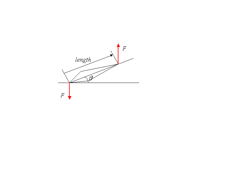

In the following question, I'm unable to find the center of mass to do the Torque calculation:
Two 59.0 N forces are applied in opposite directions to the 13.6 cm long figure shown. If the angle θ=37.0°, what is the net torque about the center of mass?
Image: http://www.freeimagehosting.net/image.php?02a6935f86.png
I get that the forces form a couple. I could do the Torque calculation but I can't figure out the center of mass of the object
Does it matter? Hint: Try finding the torque about two different points.
