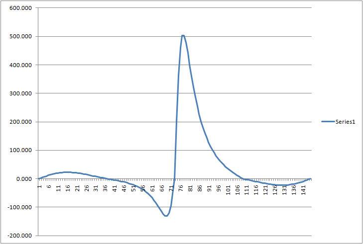

Assuming you have a uniform expansion of gasses upon their ignition from the top most piston position to the bottom, would the force generated on the crankshaft vary at different points in the down cycle? My logic tells me that when you are in the top most part of the cycle, you would have a tiny component of force directed downwards and most of the force being exerted perpendicular to where you want it to be moving, then as you reach the middle of the cycle, the gases are finally pushing the rod directly downwards and hence peak force and then it tapers off again. Is this correct?

You have the right idea, the torque produced is the product of both the cylinder pressure (diminishing) and the mechanical leverage on the crank (rising and falling in a roughly sinusoidal manner). The peaks of both factors are not in the same locations so you end up with a slightly different torque curve to what you might expect over a full cycle.
Here is a simulated torque output for a single cylinder over 360 degrees of crank rotation:

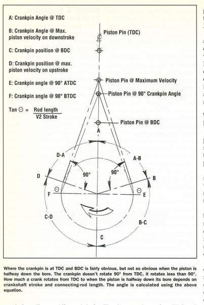

I suggest a review of the mechanics that occur is in order. The crankpin is not 90 degrees from TDC or BDC when the piston is at mid stroke. In fact when the crankpin is at 90 degrees the piston travels more than half stroke from TDC. Because the piston travels farther during the " first " 90 degrees, of crank rotation the piston velocity is higher from TDC to the mid point than it is during the last half of crank rotation.
SEE post gas pressure in internal combustion gasoline engine 22 Nov 09 on this forum
