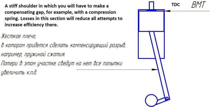

The working mixture ignites at TDC, and at this point the crankshaft looks up (0 degrees). As the piston descends, the force that the piston needs to travel a certain distance (for example, 1 mm) decreases, up to the moment when the knee rises at 90 degrees. Further, on the contrary, - the force that the piston needs to travel a certain distance increases, up to the moment when the knee rises at 180 degrees.
The pressure of gases at TDC (0 g) is maximum, decreases due to an increase in volume as the piston is lowered, and does not remain constant, since the time of flame propagation at TDC can be neglected.
It turns out that the internal combustion engine uses the energy of combustion very ineffectively; they also include new "developments" with a rail instead of a connecting rod. Why ineffective? Therefore, as most of the energy (in this case, heat), created in the range of 0-90 degrees, the engine spends on heating, or rather on the forced removal of heat.
My idea: At the TDC point, the crankshaft knee should be approximately 80 degrees. Because this is the only way to achieve maximum efficiency.

Your engine has zero compression and zero efficiency because the piston smashed the cylinder head completely off the engine when the crankshaft passed 80 degrees before top dead center. Either that, or the connecting rod was destroyed.
Ideas about linkages should be checked by drawing the system to scale, with a separate drawing at regular intervals.

This is impossible. The connecting rod is rigid and so when the piston is at the top of its travel ("Top Dead Centre") what you call the "crankshaft knee" is also at the top of its travel.
Yes. In this case just one more drawing will do: draw the crankshaft 80° earlier (i.e. rotated anti-clockwise) so that the crank is at the top of the crankshaft. Make sure the connecting rod, piston and cylinder are the same size as the original drawing. Where is the piston?

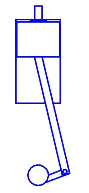

I really cannot accept that the forum participants do not understand what this is about. They really think that I'm not going to change anything in Crank mechanism. I repeat, I am not asking how to do this, the question is different.
I argue that if engineers succeed in creating an engine in which the piston, being at TDC, will turn the crankshaft turned by 75-80 degrees further up to 150-160 degrees, then the efficiency of this engine, due to a decrease in heat losses, which occurs due to the fact that a good moment of pressure increase in the combustion chamber occurs in an unsuccessful turn of the crankshaft, will increase by 30%.
Question - prove that this will not happen. The question of creating a mechanism is not yours or my business, if it is necessary, then creating such a mechanism is as easy as shelling pears.
For example, in 2017 on the Russian forum, as soon as I created a similar topic, the fourth message was answered: "Either I did not understand something, or ..." and he inserted pictures, the scraps of which I inserted in my first message hoping that everything is clear from the text of the first post. Now I am showing the same picture with an English translation. Of course this is not a solution. The user just wanted to understand what I mean.

Enough is enough. The OP has been told several times, by different people, how to analyze his idea. He has been told that it cannot work, and why. He refuses to listen. Thread closed.
