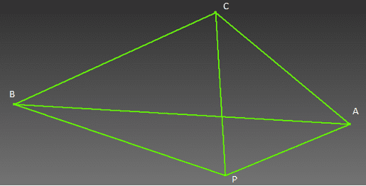

Here's a picture of an irregular tetrahedron, for reference:
The base triangle (ABC) is completely known (lengths AB, AC, BC, and the angles between them are all known). The 3 angles at vertex P are also known (APB, APC, and BPC).
I believe that is enough information to completely solve the rest of the lengths and angles. I used the law of sines and the 180 degree constraint for each of the 3 unknown triangles. With a bit of algebra I can get 3 equations with 3 unknowns, but they're too messy for me to solve.
If anyone can figure this out, I'd greatly appreciate it.
The obvious equations are the cosine rule, producing 3 quadratic equations in the three unknowns. Eliminating one unknown between two of these produces a quartic. Eliminating the second gives an 8th power polynomial. Is that what you did?
I doubt there's an easier way.

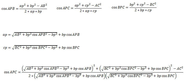

I actually was using the sine rule instead of the cosine rule, but the cosine rule seems like it might be a more direct way to go about this. I can get an equation with a single unknown pretty easily, however it seems very difficult to actually write this equation in terms of the unknown, as shown below:
The variable bp is the unknown. Any idea how to do this?
That looks even worse than the 8th power polynomial I was expecting. Can't remember how I deduced that. But even if you got to that, you would only be able to solve it numerically. So you might as well do that with the equation you have.
