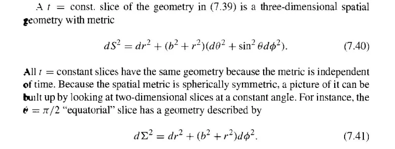

As for the metric. It is the same as the embedded wormhole idea in JB Hartle's Gravity (starting at page 148):
I'm using the final metric (my θ and φ are swapped) and I would've thought so was the person who calculated the geodesics on Wikipedia.

What do you mean by "the final metric"? If you mean 7.40 or 7.41, geodesics of spatial slices aren't generally the same as the projection onto a spatial slice of the geodesics of spacetime, and that may be your problem.
The geodesic equations I get using Hartle's notation and assuming without loss of generality that we're on an equatorial path (constant ##\theta=\pi/2##) are:
By the final metric I did mean 7.41. Regarding time's inclusion/exclusion in the manifold (which I think you are saying is the problem), is it likely that whoever made the geodesics on Wikipedia had just used r, theta (or phi in your case), and time, and then "squashed together" all the points through time such that they lay on one 2D manifold? To create:

OK, so the wormhole metric (7.39) in post #4 is$$ds^2=-dt^2+dr^2+(r^2+b^2)(d\theta^2+\sin^2\theta d\phi^2)$$We can immediately see from the spherical symmetry that we can simply assert that our orbits lie in the equatorial plane (##\theta = \pi/2##, ##d\theta=0##) and simplify to$$ds^2=-dt^2+dr^2+(r^2+b^2)d\phi^2$$Writing the Lagrangian$$\mathcal{L}=-\left(\frac{dt}{d\tau}\right)^2+\left(\frac{dr}{d\tau}\right)^2+(r^2+b^2)\left(\frac{d\phi}{d\tau}\right)^2$$we can write the Euler-Lagrange equations ##\frac{d}{dx_i}\mathcal{L}=\frac{d}{d\tau}\left(\frac{d}{d\dot{x}_i}\mathcal{L}\right)## for ##x_i## being ##t##, ##r##, and ##\phi##:$$\begin{eqnarray}
