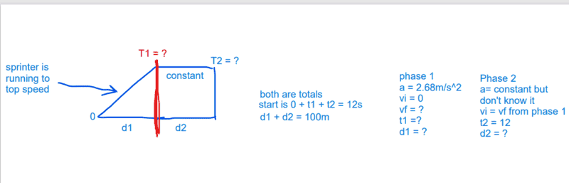

Can you post your diagram? There are two areas: a triangle for the acceleration and a rectangle for the constant velocity. There are two times ##t_1## and ##t_2##, adding to a total of ##T = 12s##, say. And, there's a maximum speed ##v## that is constant for the second phase.
And, if we call the areas ##d_1## and ##d_2##, then ##d_1 + d_2 = d = 100m##.

Okay, but ##t_2 \ne 12 s##. The time of ##12s## is the total for the race. So, ##t_1 + t_2 = 12s##.
I wouldn't worry about ##v_i## and ##v_f##. You have a single maximum speed ##v## at the end of the acceleration phase, which is sustained for the second phase.
To give you a bit of help, the distances are ##d_1 = \frac 1 2 vt_1## and ##d_2 = vt_2##. Can you make progress from there?
Note that ##v = at_1##.

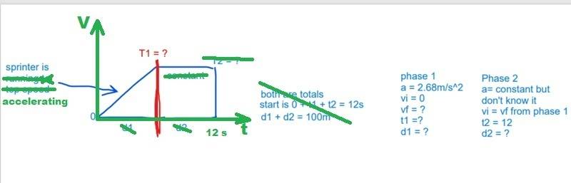

Your graph should be velocity versus time.
You will have a line starting at the origin with a slope equal to the acceleration (y=mx).
You will have a second line, horizontal, representing top speed.
The point at which both lines intersect represent the time at which there is a transition from accelerated rectilinear movement to constant velocity.
Now, the total distance of 100 meters is the area under the sloped line (t=0 to t=transition time) plus the area under the horizontal line (t=transition time to t=12 seconds).
Area triangle + Area rectangle = 100
Resolving that, you will have a quadratic equation and the value of the transition time.
With that, you can calculate how far the sprinter run during the acceleration phase.

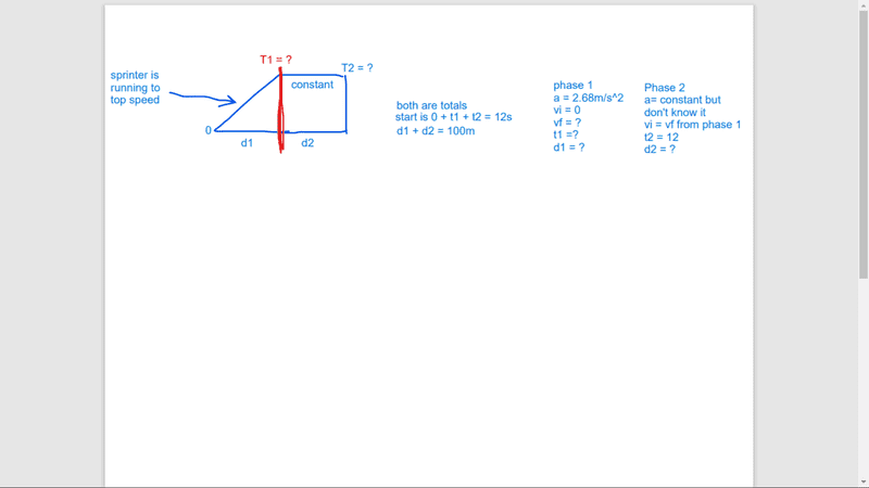

Mjusttheletter said:
can you explain a little how would it plug in or work out with the three equations that's the part I got stuck on with how it would work
There are three related unknowns ##v##, ##t_1## and ##t_2##. You need to eliminate two of these from your equations. "Elimination" is an important algebraic idea. You need to understand this idea.
First, we have ##t_1 + t_2 = T = 12s##. So, we may replace ##t_2## by ##T - t_1## in our equations. Second, ##v = at_1##, so we may replace ##v## by ##at_1## in our equations.
That leaves ##t_1## as the only unknown in our equation(s). And, in fact, you should be left with a quadratic equation in ##t_1##, which you can solve for ##t_1##.
