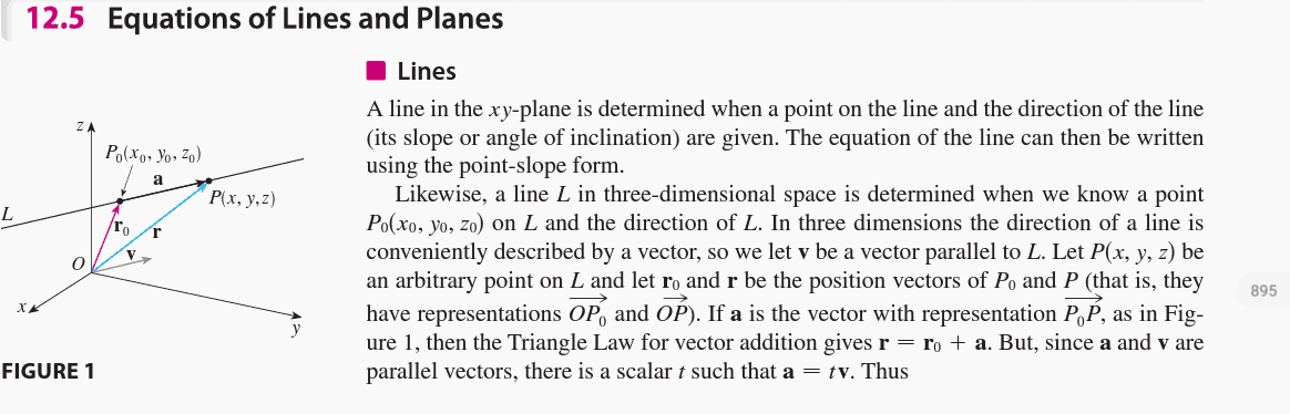

ok not sure how to start on this the book example is in the spoiler
direction vector, $v = (11,-4,48)-(-2,18,31) = (13,-22,17)$
$r(t) = (-2,18,31) + (13,-22,17)t$
