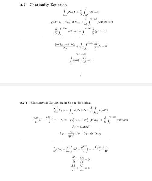

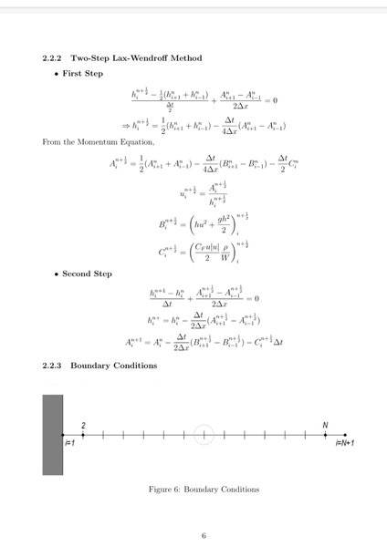

Hey everyone,
I’m trying to simulate a 1D Shallow Water wave in FORTRAN using the Lax Wendroff Method. The case is fairly simple. I have a wave generator on one end of a water pool and a wall boundary on another. The waves start traveling towards the wall and are ‘reflected off’ the wall. The problem which I’m facing is the Boundary Condition on the wall.
My generated wave starts traveling towards the wall and once it reaches the wall, my solution crashes. I need an appropriate ‘reflective boundary condition’ at the wall. As you guys already know, the Lax Wendroff Method employs a half time step. The governing PDE’s are attached in the image. The discretised equations are also attached.
Since h and A are the unknowns we are dealing with, I need the following BC at the wall:
HNP102(1)=? !1/2 Time Step, denotes n
ANP102(1)=? !plus half
and
HNP1(1)=? !full time step, denotes n
ANP1(1)=? !plus 1.
I read a similar code where
HNP1(1)=HNP1(2)
ANP1(1)=ANP1(2) was used but in my case it did not work.

The question is that what must be an appropriate 'reflective boundary condition' at the wall to simulate the reflection of the shallow water wave?
and
ANP1(1)=? !plus 1.
HNP1(1)=HNP1(2)
This isn't very explanatory -- we have no idea what HNP102, ANP102, HNP1 and ANP1 are supposed to represent. In addition, the text in the two images you posted is too small to be legible, so those images aren't much help, either.
