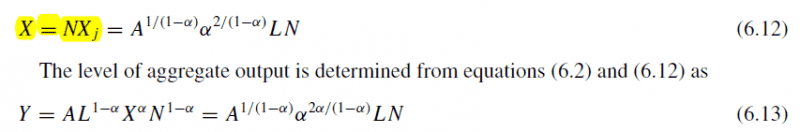

I have two equations.
1. b(N) = rN^k
2. bN° = Y - X - C
How can I find an expression for N°/N
I am a little lost here since I don't know much about the properties of differential equations. So my attempts at solution has been to take the derivative of the first equation and call it N°, which I don't know if I am alloved to do. Then insert it into the second equation and solve it for N. It doesent seem to be right.

Does your mysterious notation ##X^o## mean ##\dot{X} = dX(t)/dt##? If so, are you saying that you have
[tex]\frac{d}{dt} \left( r N^k \right) = Y- X - C?[/tex]
Are ##r,k## constants? Are ##N, Y, X,C## functions of ##t##? And, if ##X^o## does mean ##dX/dt##, where in your equations is there anything that tells you about ##dX/dt##?
Please try to submit complete and readable questions, using standard notation.
The question is from a paper.
They write:
If we substitute the formula for R&D cost from equation 6.36 into the resource constraint 6.23 we get:
Equation 6.39: Ṅ/N = (ψ1/φ)·N^(-σ) − (C/φ)·N^(-(1+σ)), followed by the definition ψ1 ≡ (1 − α²)·A^(1/(1−α))·α^(2α/(1−α))·L > 0, a constant for a fixed L.
6.36
Equation (6.36): eta(N) = phi N^sigma, where eta is a function of N with coefficient phi and exponent sigma.
6.23
Equation numbered (6.23): eta times the derivative of N equals Y minus C minus X, written as a single displayed line.
X and Y
Two displayed equations numbered 6.12 and 6.13: X = NX_j = A^(1/(1-α)) α^(2/(1-α)) LN, and Y = AL^(1-α) X^α N^(1-α) = A^(1/(1-α)) α^(2α/(1-α)) LN, with the X = NX_j on the first line highlighted in yellow.
I don't really expect an answer here because I still think my post is not good enough. And also I can't bes sure I have provided you with all the necessary information, but if what they have done is intuitive to any of you and that you understand what they did, I would very much appreciate an answer.
