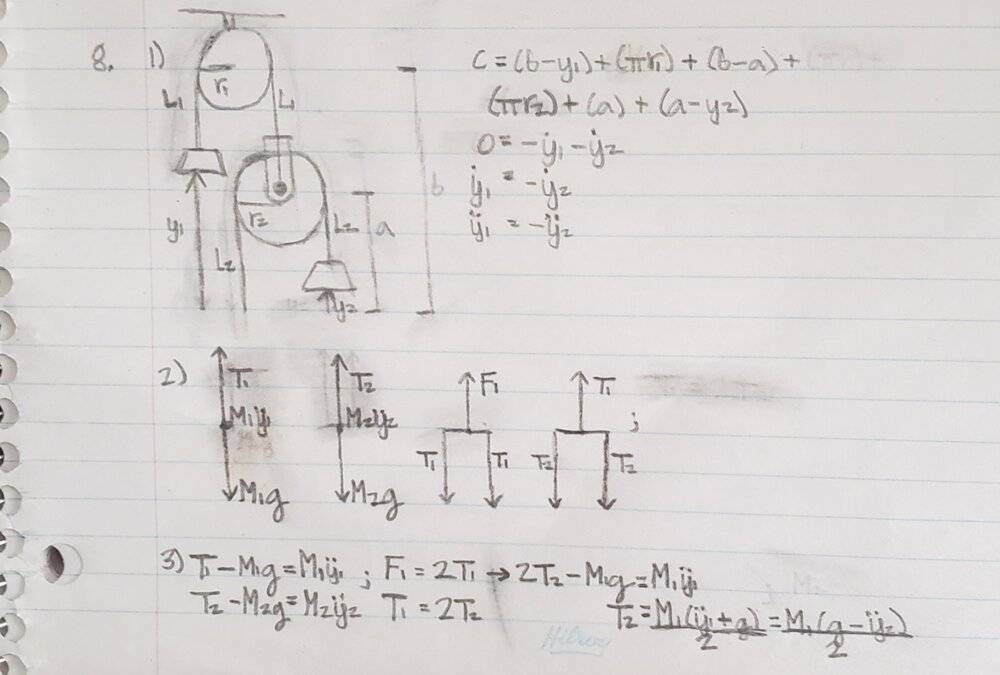

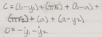

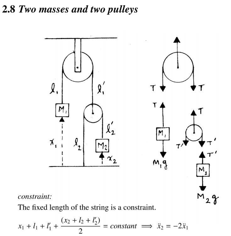

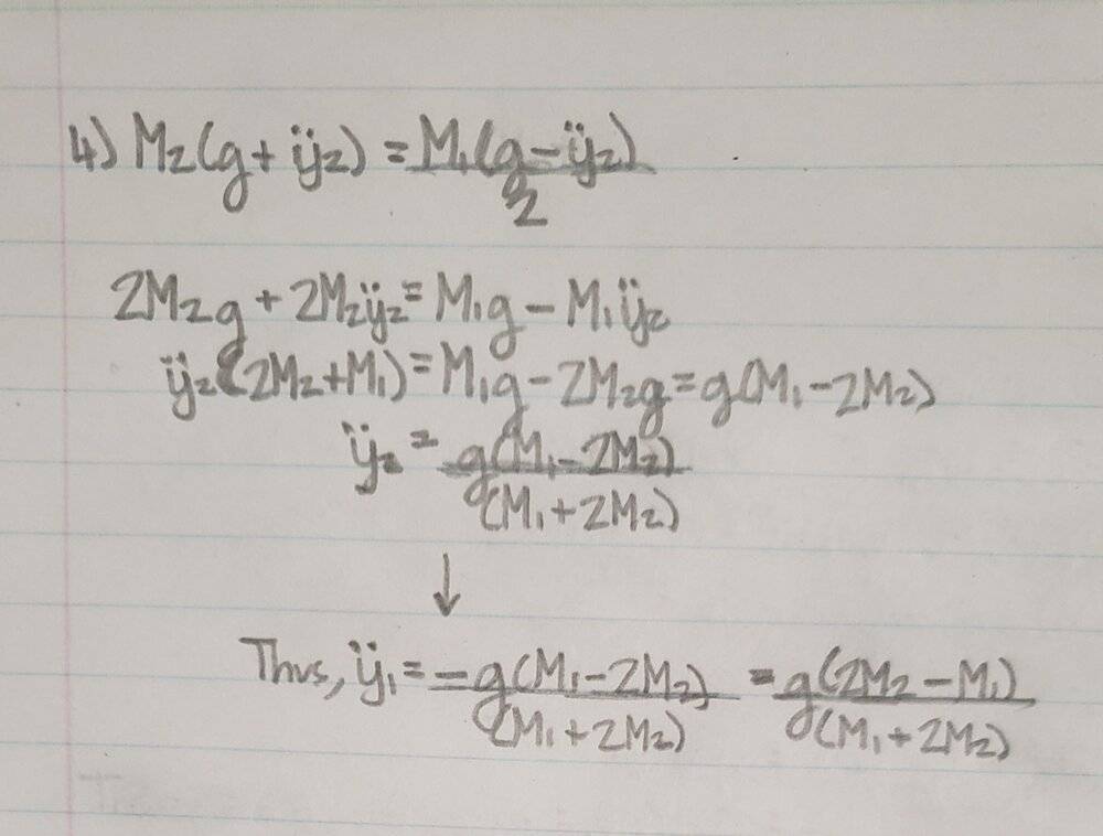

Masses M1 and M2 are connected to a system of strings and pulleys as shown. The strings are massless and inextensible, and the pulleys are massless and frictionless. Find the acceleration of M1.
x_1 + L_1 + L'_1 + (x_2 + L_2 + L'_2)/2 = constant C
For the official answer, I would appreciate an explanation as to why there's a division by 2 in the constraint equation for the total length of the strings, and why the way I wrote my constraint equation is incorrect.
Their constraint equation does not represent the total length of the strings. But it does represent a certain fixed quantity. Try to identify what it represents.
When you took the time derivative of the first equation, did you treat ##a## as a constant?
