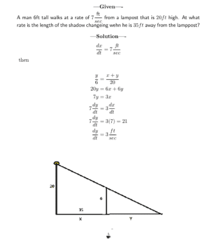

ok just seeing if this is ok
where does the 35 come in ?
I tried to follow an example but??
is not x=35
  • Handwritten solution to a related-rates problem: lamppost of height 20 and man of height 6 with distances x and y, equations y/6 = (x+y)/20, 7y = 3x, and dy/dt = 3(dx/dt) = 21 ft/sec, with a labeled right-triangle sketch.
Let's generalize a bit and let $P$ be the height of the post, and $M$ be the height of the man, where $M<P$. Using the provided diagram as a guide, we see from similarity that:
$$\frac{x+y}{P}=\frac{y}{M}$$
Arrange this as:
$$y=\frac{M}{P-M}x$$
Differentiate w.r.t time $t$:
$$\d{y}{t}=\frac{M}{P-M}\d{x}{t}$$
Do you see now that $$\d{y}{t}$$ is independent of $x$ (the distance between the man and the pole)? It depends only on the ratio of the man's height to the difference between the height of the pole and the man, and on $$\d{x}{t}$$. That's why you don't see 35 in the solution.
Suppose two men are walking at the same constant speed along a line connecting them and the pole...and one man is taller than the other...whose shadow changes length more quickly?
ok, see your point guess they just put it in there to brain twist some
so I presume that $3 ft/sec$ is correct
I looked at 5 examples they all did something different?
