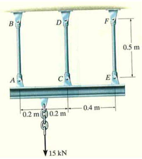

I need to determine the forces developed in each bar as shown in the attached drawing.
I have taken moments about the points A, C and E and come up with 3 equations and 3 unknowns.
Mom@A=0
0.4C+0.8E=3000
Mom@C=0
0.4A-0.4E=3000
Mom@E=0
0.8A+0.4C=9000
Whenever I try to solve for one of the unknowns, the other unknown cancels out meaning I cannot get an answer.
Is there a simpler way of solving this which I am overlooking?
Thanks in advance.
Adam

Heloo a_hargy,
Welcome to Physics Forums!
I think I see what's going on. (And RockFreak, I don't think your approach is going to work by itself this time, for reasons I shall describe below).
It's obvious that you have 3 equations and 3 unkowns. But what's not so obvious is that the three equations are not linearly independent.
You can see that
\left[ \begin{array}{ccc}0 & 0.4 & 0.8 \\ 0.4 & 0 & -0.4 \\ 0.8 & 0.4 & 0 \end{array} \right] \left[ \begin{array}{c} A \\ C \\ E \end{array} \right] = \left[ \begin{array}{c} 3000 \\ 3000 \\ 9000 \end{array} \right]
But the determinant of the matrix is zero
\left| \begin{array}{ccc}0 & 0.4 & 0.8 \\ 0.4 & 0 & -0.4 \\ 0.8 & 0.4 & 0 \end{array} \right| = 0
The matrix has no inverse. Which indicates that the equations that you chose are not linearly independent of one another. You need some other equation to solve this problem that is linearly independent of the other two.
It turns out that you can throw away anyone of the original equations, and the other two are linearly independent of each other. But you will still need a new third equation (more on that below)
Just a example of what linearly independent means. Suppose we have the equation,
x + y = 1
and we need another equation to solve for x and y. Well we could just say,
2x + 2y = 2
That gives us 2 equations and 2 unkowns, so we can solve for x and y right? Wrong. The equations are not linearly independent. The second is just the first, multiplied by 2. [Edit: By that I mean that the second equation gives no new information, that is not already present in previous equations.]
Anyway, back to problem of this thread. Throw away one of the three equations you have now. You'll need to find a new third. And don't bother taking the moment around some different point, because that won't help either this time. But there is an easy equation that you may have forgotten to use, that doesn't have anything to do with moments (Hint: what is the sum of A, C and E? :wink:)

The full problem definition is:
The three steel bars shown in the figure are pin connected to a horizontal rigid member. If the applied load on the rigid member is 15kN, determine the force developed in each bar. Bars EF and AB each have a cross-sectional area of 25mm2 and bar CD has a cross-sectional area of 15mm2.
Thanks so much for all your help!

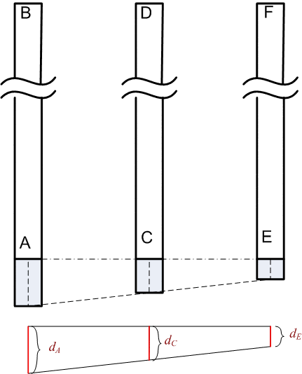

Hello a_hargy,
Just so you know, I came up with a solution to the problem. Again, it's been a very long time since I've worked with these sorts of problems, but I think it's correct. I can't give you my answer, but here is a general outline.
(i) You already have a few equations you derived in your first post. Pick any two of them. You can still use them later.
(ii) I made the assumption that any stretching of the bars is so small, that it does not have any significant impact on first two equations, so we can use them the way they are.
(iii) You can use the new information about the cross sectional area of each bar to find the third equation.
(iv) When the load is applied, and the bars elongate slightly, the elongation pattern forms a trapezoid. Think of a rectangle, except with a slanted bottom. The bottom left corner is A, the bottom right corner is E, and C is right in the middle. Using simple geometry, derive an equation which shows the relationship between dA, dC, and dE, the vertical displacements at each point.
(v) Use the cross sectional area information to model proportional "spring constants" to bars AB, CD, and EF. The way I did it, you don't need to calculate the actual spring constant values. Rather you just need relative values. The differences in cross sectional areas is the key here (at least the way I did it).
(vi) Using that you can find a new relationship between the forces A, C and E (noting that d = F/k, for displacement d, Force F, and spring constant k). That's your new third equation! (And it is linearly independent of the first two.)

a_hargy said:
I used the assumption that the elongation of AB/0.8m was equal to the elongation of CD/0.4m then used my previous equations to solve for the unknowns.
I don't follow what you mean here. Wouldn't that make the elongation of EF 0.0 m ([Edit: or would that be ∞ m?])?
Don't make the assumption that the elongation of E is anything in particular. All you need to do is find a relationship between the 3 different elongations. Perhaps this figure will help:
Realize that bar CD is directly in the middle of the other two (this distance from bar CD to bar AB is exactly the same distance from bar CD to EF).

My answers were different. They were not too terribly different, but different enough to certainly be different.
A simple approach to this is to 'move' the 15 kN force to C, but also impose there a moment of 15 x 0.2 kNm anticlockwise. The 15 force in the middle stretches the 3 bars equal amounts. The moment leaves the force at C unchanged and is resisted by forces in A and E. This will act as a check on the way you did it otherwise.
