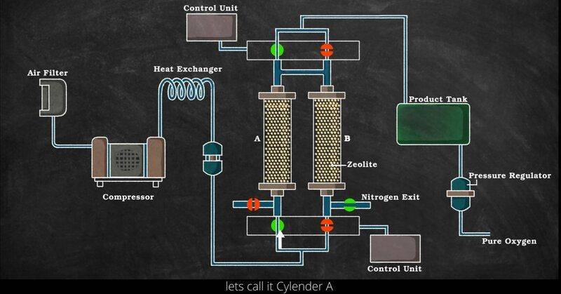

Instead I bought an Oxygen Concentrator similar to the following plugged into AC power.
But how could you bring this to car in case you got Covid and your doctor told you to use oxygen while lining up inside hospitals in cars (when you can't find oxygen tanks).
I know all PF mentors are so nervous for any medical advice that can make people sue them and put them in jail. So they just locked any thread threatening them .But I'm NOT asking for medical advice because I don't have covid. ok?
I'm just asking is it practical to use power inverter on an oxygen concentrator inside car with a 60HA battery drained in just 2 hours? And would a generator work? I guess to avoid CO building inside car. You have to put the generator on top of car like in ghostbusters or in the trunk. Or there is just no way to put a generator inside car?
Or maybe put the generator outside car lined up in hospitals.
Look at the diagram of an oxygen concentrator. It has compressor. Does generator produce square or sine waves AC and can a compressor use square wave AC?

A generator will produce a sine wave.
An inverter that proudly advertises sine wave is the only kind that will certainly produce a sine wave. They are more expensive than the pseudo-sine ones that are basically a couple of overlapped square waves. If not advertised as sine then it probably is not since the manufacturer would not pay for the more expensive parts and then not charge the premium price.
The motors in the concentrator may run on the pseudo-sine inverter but this is a rather expensive device so I personally would not do that. The motor itself may sound different but the pumps and fans also make noise so that would not be a good way to identify the inverter.
