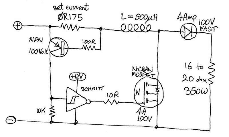

Hi,
I'm currently working on my end of the year project for my studies.
I have a DC motor mechanically linked to a wind turbine PMA. My aim is to control the speed of this motor (using PWM) to simulate different types of winds.
My problem lies on the generator side. I need a load to dissipate the output power, but considering the fact that the output will constantly change (eg. gust of wind corresponding to a steep rise in speed) I need it to be automatically variable. I thought that a JFET would do the trick, but unfortunately they only support around 1 A at most. My PMA will deliver a maximum power of 350W and the 3 phase output goes through a rectifier to convert it to single phase.
I have no idea what I'm looking for and what kind of solution I could use.
Please help

Notice that the current does not change much with RPM. You can simulate those load characteristics with a 3.85 amp constant current sink, rated at 250W, in parallel with a 39 ohm resistor rated at 100W.

If you want an automatic load then you would need to build a 4 amp constant current sink. The best way to do that would be with a switching current regulator into a 350 watt load of between 16 and 20 ohm. Attached is a schematic of such a beast. It works by turning on the mosfet until the current through the inductor rises above 4 amp, the transistor then turns off and the current flows through the diode and 16 ohm load. When the current falls again below 4 amp, the transistor switches on, and the cycle repeats. The transistor needed is only a low cost 4 amp, 100V N-chan mosfet. The duty cycle is voltage dependent so the same resistive load can serve all RPM requirements.
If you want more info about a switching current sink, ask more specific questions. But consider first a manually switched load bank, it is much easier.

EDIT: I hadn't seen the following comments. I will look into this current sink system. For the incandescent lamp, I have considered it however since this project will later be used for teaching purposes I have been told it would be a problem if several units emitted 350W of light in a single lab (where solar panel measurements are also made).

The 100 watt 39 ohm resistor seems OK. It may be worth doing a more accurate analysis of the graphs before purchasing.
It is true that 3.85A will dissipate 250W in a 250/3.852 = 16.866 ohm resistor.
Unfortunately, it is NOT relevant to this design.
Your understanding of the 250 W switching load has not quite caught up yet.
Remember that for an inductor, V = L * di/dt
A reversing voltage difference will appear across the inductor, but the current stays close to the set value.
When the transistor switch is on, inductor current accelerates, downhill to ground.
When the transistor switch is off, inductor current decelerates, uphill through the diode and resistor.
The switch duty cycle will vary but, if the transistor remains off, the current through the diode and 250W resistor must not exceed the regulated current of 3.85A at the maximum generator voltage of 64V. Therefore 64V / 3.85A = 16.623 ohms minimum. That ignores the voltage drop across the diode and inductor, which happen to be in our favour.
There is also a maximum resistance value. The transistor and the diode have a maximum voltage specification, to keep the cost down I set it at 100V. The high voltage is developed across the resistor while the transistor is switched off. 100V / 3.85A = 25.97 ohms.
The minimum is 16.7 ohm, the maximum is 26 ohm, the standard values of 18 or 22 ohms lie in that range so either will do the job.
If the transistor and diode were rated at 600 V you could use 600V / 3.85A = 155.8 ohms maximum, so the standard value of 150 ohms would then do. However, the voltage across the inductor would be 6 times higher. Since V = L * di/dt, the current would change 6 times faster, and the mosfet would have to switch more often.
Ok thank you for the greatly precise and clear explanation. I will definitely look into this system in detail. Should the additional resistor (theoretically 39 ohms/100W) then be added in parallel to this current sink system (I would guess before the MOSFET)?
The + and – terminals on the left of my circuit diagram should be connected in parallel with the 39 ohm load resistor and the generator. That way the generator current is the sum of the 3.85A constant current and the voltage dependent current through the 39 ohm resistor.
