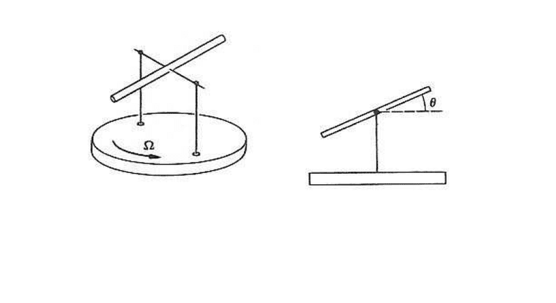

A thin uniform rod is attached to an axis through its midpoint. The axis is standing on a disk rotating with constant angular speed [itex]\Omega[/itex] about its symmetry axis. The rod's midpoint is located directly above the rotational axis of the disk. Let [itex]\theta[/itex] denote the rod's angle with the horizontal plane. Determine how [itex]\theta[/itex] varies with time.
Pictures are attached below to make the above description clearer.

  • Two diagrams: left, a thin rod pivoted at its midpoint on a support above a rotating disk marked with angular velocity Omega; right, the rod tilted at angle theta above horizontal on a central post over a flat base.

I now realize one mistake I made in my original post. The paragraph about the accelerated reference frame introduced makes no sense. The origin 0' is put at the midpoint of the rod, such that the origin remains constant throughout the motion. The x- and x'-axes should coincide, and be perpendicular to rod and parallel to the xy-plane (plane of the disk). The y'- and z'- axes are then tilted an angle [itex]\theta[/itex], such that O'x'y'z' becomes a principal coordinate system for the rod.
Then I think the angular velocity vector [itex]\mathbf{\omega}[/itex] should read something like
[tex]\mathbf{\omega} = \dot{\theta} \mathbf{e}_{x'} + \Omega \sin \theta \mathbf{e}_{y'} + \Omega \cos \theta \mathbf{e}_{z'}[/tex]
Euler's equations then gives
[itex]\frac{1}{12}ml^2 \ddot{\theta} = 0[/itex]
[itex]0= 0[/itex]
[itex]-\frac{1}{12}ml^2 \Omega \dot{\theta} \sin \theta - \frac{1}{12}ml^2 \Omega \dot{\theta} \sin \theta = 0.[/itex]
Maybe there should be an extra minus sign in the last equation, so that the terms will cancel out, but I can't figure out where the mistake is if there is one. Then I get [itex]\ddot{\theta} = 0[/itex] and I guess [itex]\theta(t) = \dot{\theta}_0 t + \theta_0[/itex].
