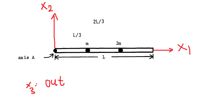

A rod of mass M and length L is rotating freely around an axis at one end. There are two particles attached to the rod at distances of L/3 and 2L/3 from the axis, with masses m and 2m, respectively. The system is only affected by gravitational forces.
A) Determine the angular acceleration of the rod and particles under these conditions. B) Calculate the angular velocity of the system when the rod is vertical after rotating 90 degrees.
Rigid body dynamics.
For the rod and the two particles ##x_1## is not zero but we have:$$x_2=x_3=0$$ We start with inertia tensor of the rod: $$ I_{ij} = \int \lambda ( \delta _{ij} \sum_{k} x^2_k -x_i x_j ) dx_1$$ $$ \lambda = constant = M/L $$ Using above equations, we have:
$$I_{11} = \dfrac M L \int ( x^2_2 +x^2_3 ) dx_1=0$$ $$I_{22} = \dfrac M L \int ( x^2_1 +x^2_3 ) dx_1=\dfrac {1}{3} ML^2$$ $$I_{33} = \dfrac M L \int ( x^2_1 +x^2_2 ) dx_1=\dfrac {1}{3} ML^2$$ $$I_{12}=...=I_{23}=...=0$$
For the two particles: $$I_{ij}=m_1(\delta _{ij} \sum_{k} x^2_{1k} -x_{1i} x_{1j})+m_2(\delta _{ij} \sum_{k} x^2_{2k} -x_{2i} x_{2j})$$ After Substituting from the information provided in problem, we get: $$I_{11}=m_1(x^2_{12}+x^2_{13})+m_2(x^2_{22}+x^2_{23}) = 0$$ $$I_{22}=m_1(x^2_{11}+x^2_{13})+m_2(x^2_{21}+x^2_{23}) =mL^2$$ $$I_{33}=m_1(x^2_{11}+x^2_{12})+m_2(x^2_{21}+x^2_{22}) =mL^2$$$$I_{12}=...=I_{23}=...=0$$
Therefore, the rigid body has an inertia tensor given by: $$I_{1}=0$$$$I_{2}=I_{3}=(\dfrac M 3 +m)L^2=\beta$$ Euler's equations becomes : $$ - \omega_1 \omega_2- \dot \omega_3=N_3 $$ $$\omega_1 \omega_3- \dot \omega_2=N_2$$ $$\dot \omega_1=N_1 $$
Could you please verify if the steps I have taken so far are correct? Any guidance or feedback you can provide would be very helpful.
I think that you are overcomplicating matters. This is a physical pendulum.
For part (A) find the distance ##L_{cm}## of the center of mass from the pivot, the moment of inertia ##I_{support}## about the support and plug in. For part (B) use energy conservation.

Are you suggesting that I consider the combined mass of ##M+3m## located at the center of mass of the rigid body, and then use the formula ##\alpha =## angular momentum / moment of inertia to calculate the angular acceleration?
By finding angular momentum using formula ##\dfrac {d \vec L}{dt}=N##.
and then use the formula ##\alpha =## N / moment of inertia ? (moment of inertia =##(M+3m)R^2_{cm}## )

Yes.

I didn’t read that in detail because it was evidently much more complicated than it needed to be.
You should be able to write down the MoIs about the pivot straight off: ##ML^2/3+m(L/3)^2+2m(2L/3)^2##.
Similarly the torque about the pivot: ##(ML/2+mL/3+2m(2L/3))g##.

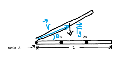

Ok. I try again using the approach sugggusted by you.
$$\alpha = \dfrac { \sum_{i} r_i F_i}{I}=\dfrac {\frac {ML}{2}+\frac{mL}{3}+\frac{4mL}{3} }{(M/3 + m)L^2}g$$ And the angular acceleration is directed out of the plane.

Didn't you forget ##\sin \theta##? If gravitional force acts downward, we have:
For part b, can I assume an arbitrary initial angular velocity ##\omega_0## and then use the conservation of energy to determine the angular velocity ##\omega## of the vertical rod?
I should just determine the change in height of the center of mass.

CoM is located at: $$ R_{CoM} = \dfrac {m(L/3)+M(L/2)+2m(2L/3)}{M+3m}=\dfrac {(M/2) + (5m/3)}{M+3m}L$$So change in potential energy of the body is: $$\Delta U = (M+3m)(\dfrac {(M/2) + (5m/3)}{M+3m}L)g=(\dfrac M 2 + \dfrac {5m}{3})Lg $$ Using conservation of energy, we get: $$\Delta T = -(\dfrac M 2 + \dfrac {5m}{3})Lg$$ $$\dfrac 1 2 ((M/3 + m)L^2)(\omega^2_f-\omega^2_0)=-(\dfrac M 2 + \dfrac {5m}{3})Lg$$ Finally, we solve for ## \omega_f ##, which is the angular velocity of the vertical rod. $$\omega_f^2=\dfrac {-( M + \dfrac {10m}{3})}{ (M/3 + m)} \dfrac g L+\omega_0^2$$ The negative sign indicates that the angular velocity should decrease, which is logical.
As I read the question, part a asks for the angular acceleration when released from horizontal and part b asks for the angular velocity at the vertical. Neither requires you to consider an arbitrary angle in between.
So the acceleration is changing by time and not constatnt ... Thank you.

If I want to find the acceleration at an arbitrary point, should I simply include the ##\sin \theta## in the equations?

In part a, nothing is rotating yet, so Euler's equation reduces to ##\vec\tau=I\dot{\vec\omega}##.
Part b is solved most simply using energy.
If you mean the generalisation of being at angle ##\theta##, that should work, but it still seems like overkill.

Thank you for your explanation, @haruspex. I understand now. I've asked the TA, and the question specifically wants us to determine the acceleration when the rod is in a horizontal position, as you said.
