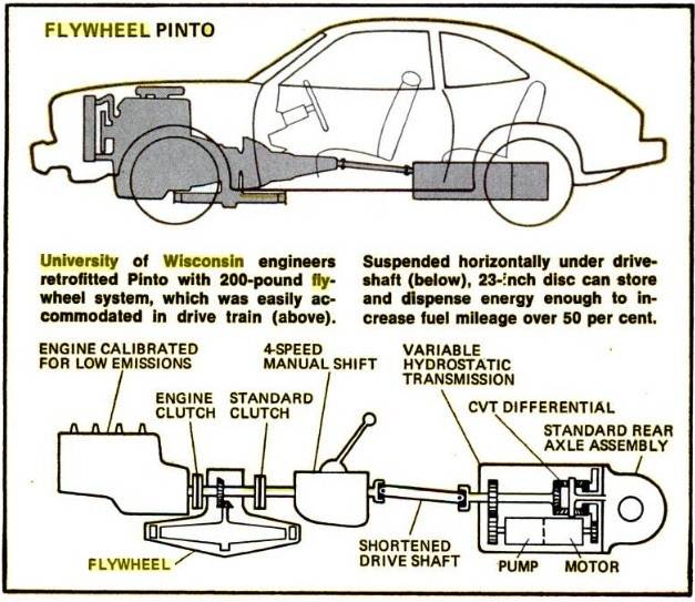

Back about 1976, a team at the University of Wisconsin - Madison built a flywheel car. They started with a Ford Pinto, kept the stock engine up front, and added a vertical axis flywheel in the space previously used by the back seat. I believe they had hydrostatic transmissions between the engine, flywheel, and rear axle. It took two people to drive; a driver and a co-driver to work the transmission controls. The car had barely enough room for the two drivers. All other space, rear seat and trunk, was filled by transmissions, flywheel, and controls. The professor in charge told me that the base car got 16 MPG, and the flywheel hybrid got 24 MPG.
I remember doing a calculation about what would happen if the flywheel bearings seized. I calculated that the car would spin about 360 degrees and come to a stop in a fraction of a second. The driver would get a case of neck twist whiplash while wondering just what had happened. Either that, or the flywheel would break free, fall onto the pavement, and bounce around tearing up the car from underneath.

Here's a figure from the February 1978 Popular Mechanics article about the UW-Madison flywheel car mentioned in Post #4. Note that the flywheel has the axis of rotation vertical.
That flywheel has maximum speed of 10,000 RPM, at which speed the peripheral velocity is 1000 ft/sec. Practical flywheels need to run at the maximum practical speed. Even at maximum speed, energy storage is low compared to batteries.
