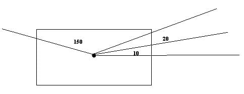

2) I have three forces acting on a 5.0kg object. What direction does it go, with how much net force is it pushed and what's it acceleration.
Forces:
30.0N at 20.0 Degrees
40.0N at 10.0 Degrees
10.0N at 150.0 Degrees

2)This one is confusing me from more of a visual standpoint. When it gives the angles I'm not sure how to visualize this. I just don't know where the force is pushing on the object. This is how I think of it but I'm pretty sure its wrong. I just don't know what to use as a marker.
You've got the right idea. Hint: Find the components of the force vectors and add them up.

2) Split all the forces into vertical and horizontal components. Get the resultant horizontal and vertical components
