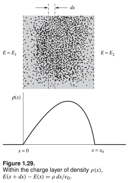

A thin shell in reality doesn't have zero thickness. Consider the image below, showing a cross-section of a small portion of the shell:
Here we are considering a more general case in which we have electric fields of magnitude ##E_1## and ##E_2## on each side of the shell.

Assume there is a volume charge density ##\rho(x)## extending from ##x=0## to ##x=x_0##. Consider a very thin slab of thickness ##dx<<x_o##, ie a very thin slice of the cross section of the shell.
The charge per unit area of the slab is ##\rho dx##. If the area of the slab is A (where A is an area that visually would be perpendicular to this screen), the total charge in the slab is
$$dq=\rho dx A$$
the force on the slab is then
$$dF = Edq = E\rho dx A$$
* this comment isn't in Purcell, but I understand that ##E## in the equation above is actually ##E(x)##.
the total force on the entire shell is ##\int dF##
and the total force per unit area on the shell is
$$\frac{F}{A}=\int \frac{dF}{A}=\int_0^{x_0} E \rho dx$$
But we know what ##\rho dx## is because we can apply Gauss's law to the slab. If we take ##(1)## and apply it to the slab we get
$$dE = \frac{\sigma_{slab}}{\epsilon_0}=\frac{\rho dx}{\epsilon_0}$$
$$\implies \rho dx = dE \epsilon_0$$
$$\implies \frac{F}{A}= \int_{E_1}^{E_2} E\epsilon_0 dE = \frac{\epsilon_0}{2}(E_2^2-E_1^1)=\frac{\epsilon_0}{2}(E_2+E_1)(E_2-E_1)$$

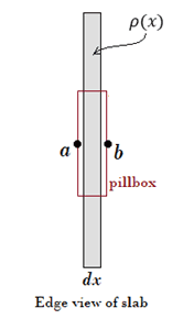

I'm not quite sure what the issue is here. Your equation (1) is for a surface of negligible thickness that has a surface charge density ##\sigma##. Now we have a slab of thickness ##dx## with a volume charge density ##\rho(x)##. If you are bothered by just switching ##\sigma## to ##\rho(x)dx## in equation (1), then forget (1) and apply Gauss' law directly to the slab. Use a pillbox Gaussian surface.
Gauss' law yields
##(E_b - E_a)A = \frac{Q_{enclosed}}{\epsilon_0}##
Note that ##E_b - E_a = dE## and ##Q_{enclosed} = \rho(x)Adx##
