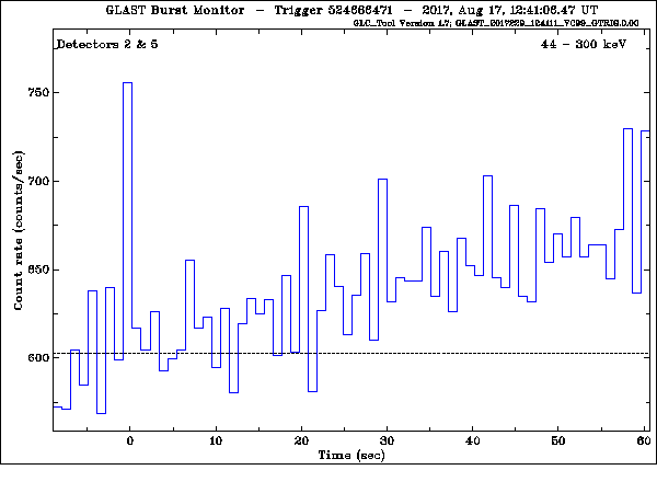

Apparently there was also an observation by Fermi of a short gamma ray burst (SGRB170817A), which may have been coincident with the GW event. If you put all this together, it sounds like the event may have been seen in gravitational waves, gamma rays, X-rays, and optical light. It sure sounds real. I can't wait for the announcement.

It would be a bit odd to have a coincident GW and GRB event attributed to a neutron star merger. From what I've heard the best guess estimates have it at about a one in fifty chance for having the proper alignment for a coincident detection. So not impossible, but it wasn't expected to be detected this early. Perhaps this means some sort of modeling error, as some of the numerical hydrodynamic simulations seem extremely difficult.
We'll have to wait for the announcements to know for sure. If this SGRB170817A is really in NGC 4993 at 40 MPc distance, I think that would make it the closest SGRB detected. Just detecting a SGRB with clear optical counterpart in a galaxy this close would be a major find, even if it isn't associated with a GW event. As to Haelfix's objection, I think that most of the gamma rays are beamed, but there are still a significant number of gamma rays emitted outside the narrow beam, so if it is close enough, we could see a GW event and a GRB at the same time even if we aren't in the narrow beam. Or perhaps the rumors are wrong or there were two different events. We'll have to wait and see.
I did find these two images about SGRB170817A at the Fermi website. I added the X at the approximate location of NGC 4993.
