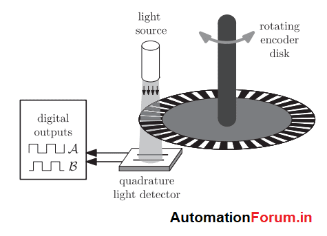

Optical encoders involve an LED, a couple of photodetectors, and a wheel, as shown in Fig. 1:
Diagram of a rotating encoder disk with radial black and white segments, a light source above it, and a quadrature light detector below with digital outputs A and B shown as square waveforms.
Figure 1: General idea of operation of optical encoder (image courtesy of ForumAutomation.com)
Although not shown in Fig.1, there are may also be reflective elements such that the LED and two photodetectors can all be mounted on the same circuit board. That is the case with the encoders involved in this thread.
Note that because there are two signals, A and B, the control circuitry is able to determine not only how far the shaft has rotated, but also its direction (clockwise or counterclockwise).

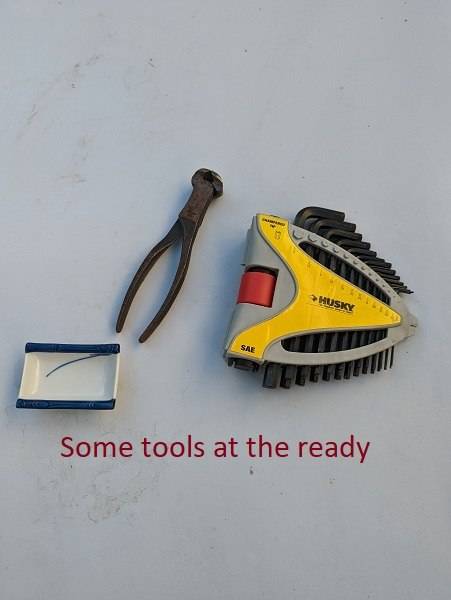

Tools and stuff:
You'll need a set of hex wrenches, a place to temporarily store several hex screws & a spring, and a some sort of clipper tool to clip off a cable tie. You also should have some cable ties for later, since we're going to be destroying one of them.

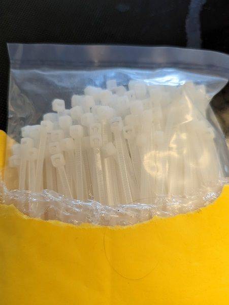

Clear zip-top bag of white nylon cable ties, packed loosely, resting on a yellow surface against a dark background.
Figure 4. Extra cable ties.
Fig. 4 shows a bag of extra cable ties. We won't need these for awhile, but we will need one before we're finished. They're very inexpensive. You can by them by the hundreds, costing just a little more than the cost of postage.

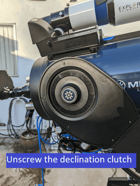

Close-up of a Meade telescope's declination axis housing with a black circular clutch knob and a graduated dial, with a caption reading 'Unscrew the declination clutch'.
Figure 6: Declination clutch knob.

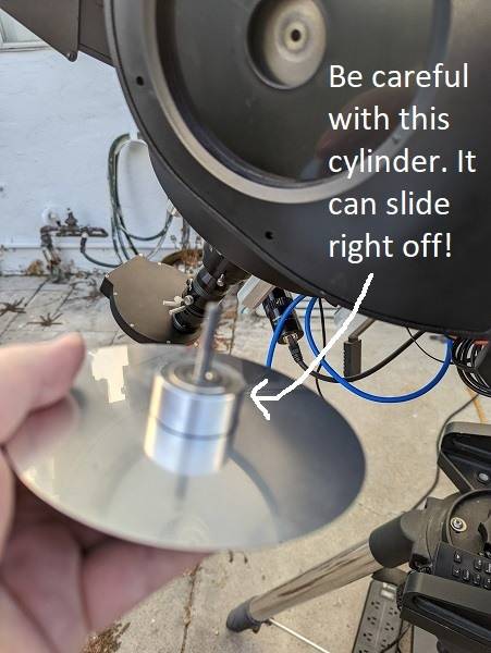

To remove the declination clutch, loosen the clutch knob, and then just keep going. Be careful though, because once the clutch knob is completely loose, things can slide off (see below). So make sure the forks are level.
Hand holding a silver-grey cylindrical motor encoder hub on a shaft above a telescope's declination axis, with an arrow and the caption 'Be careful with this cylinder. It can slide right off!'
Figure 7. Declination clutch knob removed.
Once the clutch knob is removed, set it and the little cylinder thing aside. Be careful with the little cylinder thing, it can slide right off the bolt. We'll come back to these shortly.

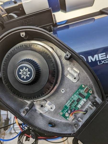

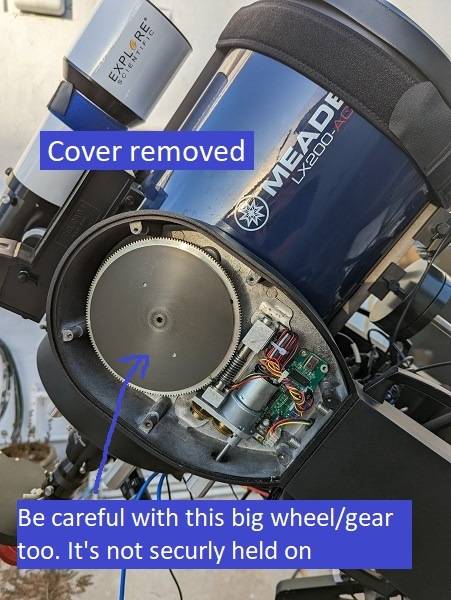

The next step is to remove the 6 hex screws holding on the cover.
Photo of a Meade LX200 telescope with its declination motor cover removed, showing a large toothed gear wheel and a small motor with wiring, labelled 'Cover removed' and 'Be careful with this big wheel/gear too. It's not securely held on'.
Figure 8. Declination mechanism cover removed.

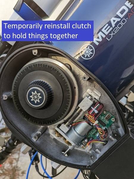

Again, make sure the forks are level. There's nothing securing the big part of the clutch and large gear at this stage, so be careful.
To keep things secure, screw the clutch knob and cylinder thing back in place -- without the cover -- just to keep things from falling apart.
Inside view of a Meade LX200 telescope's declination housing with the clutch removed, showing the graduated dial ring, a motor with a worm gear, and a green circuit board with wiring. A blue text box reads: Temporarily reinstall clutch to hold things together.
Figure 9. Clutch knob and cylinder thing temporarily reattached.

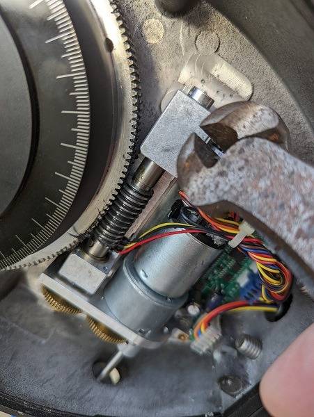

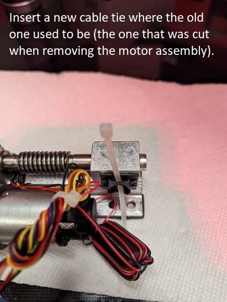

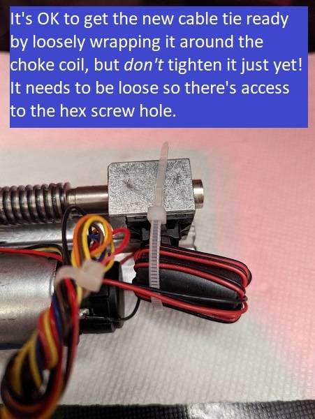

Take note of the cable tie and how it is affixed. We're going to cut that cable tie in order to gain access to a larger hex screw which is being blocked beneath the choke coil.
Photo of the inside of a telescope mount showing a declination motor with a gear drive, a black cable tie holding red and black wires, and a green circuit board with a bundle of colored wires.
Figure 10. Declination motor assembly, still attached, prior to disassembly.
Close-up photo inside a telescope mount showing a gray geared motor, a threaded lead screw, a green circuit board with colored wires, and a metal bracket, with a gloved hand holding pliers at upper right.
Figure 11. Cutting the cable tie.
Be careful not to accidentally cut any of the electrical wires.

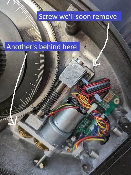

Interior of a telescope mount showing the declination drive: a gear-toothed altitude scale ring, a motor with a gearbox, a lead screw, and a circuit board with colored wires. Handwritten-style blue labels read "Screw we'll soon remove" and "Another's behind here", with arrows pointing to a screw and to a spot at lower left.
Figure 12. Take note of the two larger hex screws holding on the declination motor assembly. We'll be coming back to those.

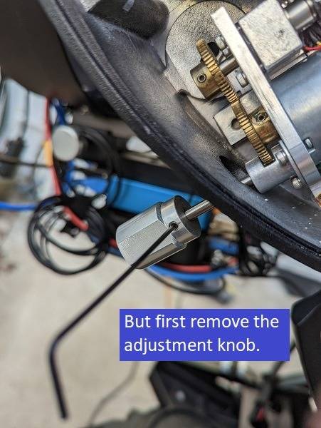

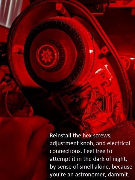

Before we remove the declination motor assembly, we'll need to remove the declination adjustment knob first.
Photo of a telescope mount with the declination adjustment knob removed, showing a hex key inserted into the exposed knob shaft and a brass gear meshed with a worm gear.
Figure 13. Declination adjustment knob removal.

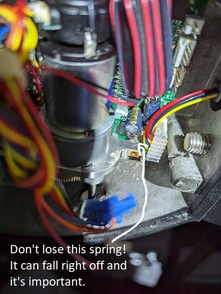

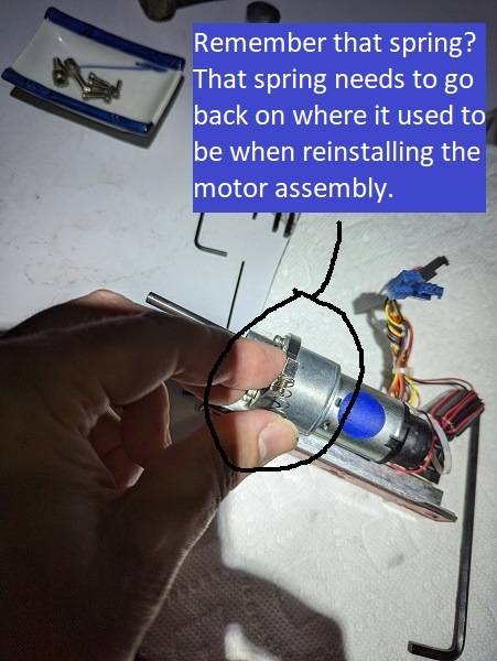

Take note of the spring that's under compression, shown in Fig. 14. This is the spring that presses the worm gear up to the big gear that we mentioned earlier. It's an important spring. When you remove the declination motor assembly, it will slide right off. So make a note of where it is/was, and try not to step on it if it falls to the ground.
Photo of the declination motor assembly inside a telescope mount, with a thin white arrow pointing to a small spring near the green circuit board and a caption reading Don't lose this spring! It can fall right off and it's important.
Figure 14. Declination motor assembly spring. Take note of this spring. Don't lose it when removing the declination motor assembly. You'll need to keep track of it when removing the assembly.

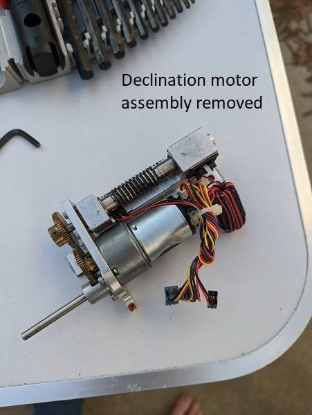

Finally we can remove those two larger hex screws that affix the declination motor assembly. (Again though, pay attention to that spring.)
Declination motor assembly removed from a telescope mount, lying on a table: a small DC motor with a worm gear, brass gears, a threaded shaft, and bundled red, yellow and black wires with a connector.
Figure 15. Declination motor assembly removed.
By the way, I should have mentioned this before, but there's a lot of grease between the big gear and the worm gear. Avoid touching that grease. The grease is where it should be, and you don't want any on your hands because you'll probably want clean hands for what's to come in the next part.
Photo of the open declination housing on a Meade LX200 telescope with the motor assembly removed, showing a large toothed gear ring, a worm gear with a star-shaped cap, and a green circuit board with wiring at the lower right.
Figure 16. Declination mechanism housing with the motor assembly removed.

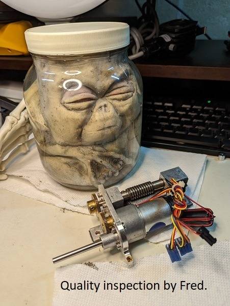

The next part is to bring the motor assembly to the laboratory (or desk or countertop or whatever).
To be continued...

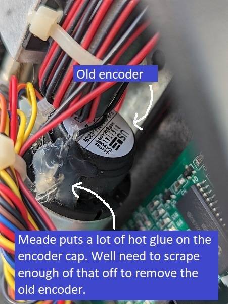

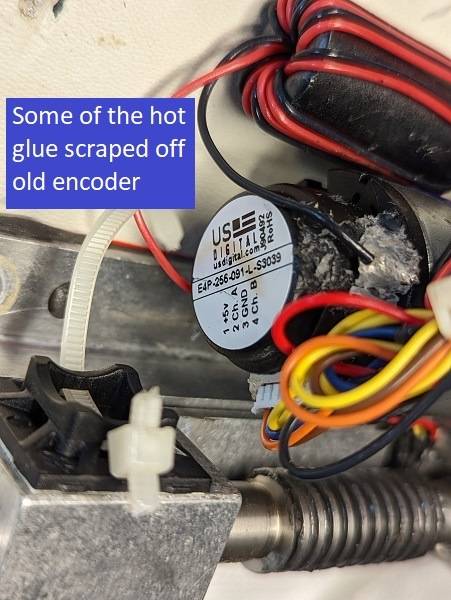

First off, Meade put a lot hot glue around the old encoder. I'm not quite sure why, but I figure they had their reasons. Much of the hot glue is concentrated around the motor's electrical contacts. So maybe it was to prevent corrosion or shorts involving the contacts.
We'll need to scrape off enough glue such that we can remove the lid/cap of the old encoder. Feel free to leave any hot glue that's not keeping the encoder lid/cap attached.
Photo of a motor encoder inside a telescope mount, with a white label reading US Digital E4P, the wire harness above it, and a hand-applied blob of hot glue on the encoder cap; annotations mark the old encoder and the glue.
Figure 17. Old encoder with a bunch of hot glue on it.
I used an X-ACTO knife to scrape away much of the hot glue.
Photo of a US Digital E4P encoder mounted on a telescope drive, with a white cable tie and wiring; hot glue scraped from its top, label reads E4P-256-091-L-S3039.
Figure 18. Old encoder with much of the hot glue cleared away.
In Fig. 18 you can see the old encoder's model number, US Digital E4P-256-091-L-S3039. As it happens, US Digital's E4P line of encoders are all discontinued. So we won't be replacing it with another encoder of the exact model. Instead, we will be replacing it with a similar E4T model. There will be a few differences between the old and new encoders.

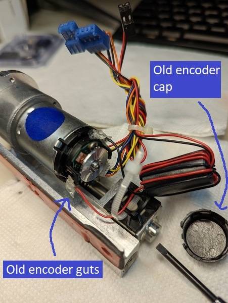

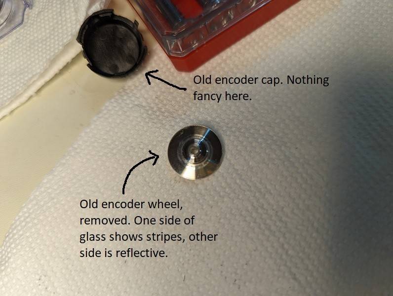

Photo of a disassembled telescope drive motor with its old encoder exposed: the cap has been removed and lies beside it, with a screwdriver tip at the lower right and blue labels marking the old encoder cap and old encoder guts.
Figure 19. Old encoder with cap removed.
Fig. 19 shows the encoder with the cap removed. Prominent in the image is the old encoder wheel. Notice that the side facing the camera is completely reflective.
Photo of a removed encoder cap, a black plastic disc with tabs, and a small metal encoder wheel on a white paper towel, with a red plastic case in the background.
Figure 20. Old encoder wheel and cap.
In Fig. 20, you might be able to make out a thin ring of stripes on the wheel on that side. The other side of the wheel is reflective though. Altogether this allows the LED and photodetectors to be placed on the same printed circuit board (PCB). Notice there's nothing special on the old encoder cap. It doesn't play a role in the encoder optics, it's just a cap. This will be a little different in the new encoder and new encoder cap.

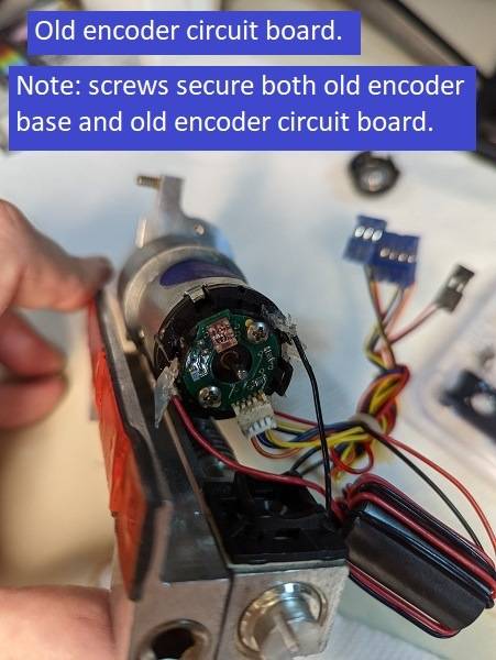

Photo of a disassembled telescope drive motor with a green circuit board exposed, mounted with screws and wired to a multi-colored ribbon cable and connector.
Figure 21. Old encoder PCB.
Once the wheel is removed we can examine the old PCB. Notice a couple of screws here. The screws secure the PCB and the encoder base (we'll get to that in a second), into the motor housing itself. There will be differences in how all this fits together with the new encoder.

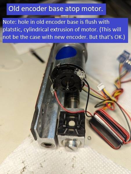

Photo of a motor assembly with its old encoder base mounted atop the cylindrical motor body, showing a black encoder housing with a shaft and wiring leads, next to a black connector block and cable harness.
Figure 22. Old encoder base atop motor.

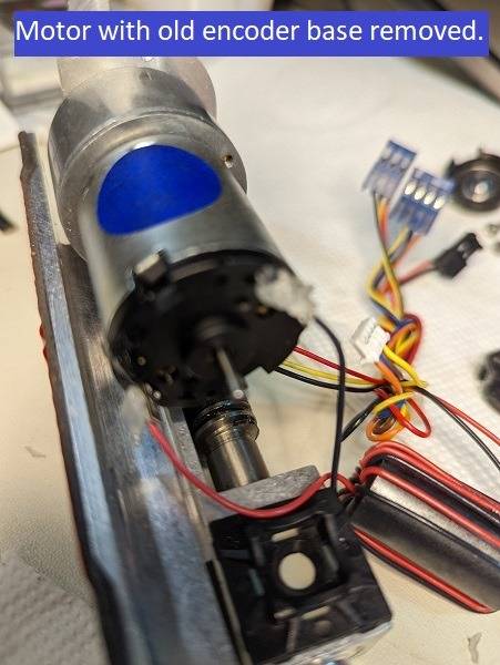

Removing the PCB we can see the encoder base as it sits atop the motor. The base contains a big hole in it, and that hole fits flush around a cylindrical extrusion (or circular "lip" if you'd rather -- I don't know what to call it) that's part of the motor housing. Things will fit together a little differently with the new encoder.
Photo of a telescope drive motor with its old encoder base removed, showing exposed motor shaft, colored wires with connectors, and the black encoder mount on a metal plate.
Figure 23. Motor housing with the old encoder (cap, wheel, PCB, base; i.e., the whole kit-and-kaboodle) removed.
Fig. 23 shows the motor housing with the encoder base removed too. Sorry about the bad focus. You can see that cylindrical extrusion/lip on the motor housing. While the old base had a hole in it that fit flush over the extrusion, the new encoder base will fit on top of it -- not through it. More on that in the next part.

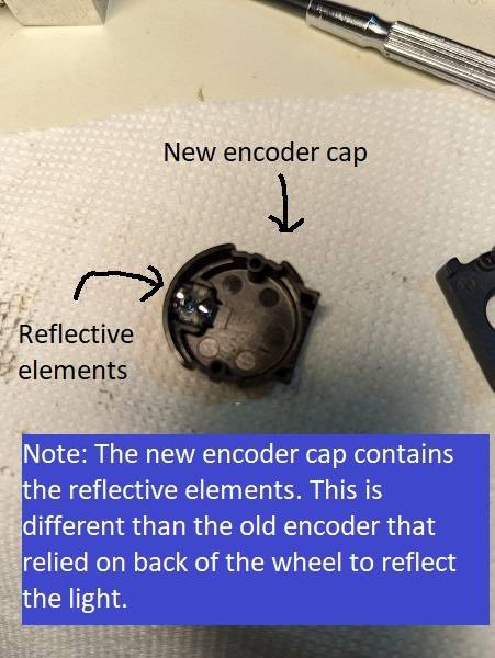

Recall the old encoder was US Digital part number E4P-256-091-L-S3039. But the E4P line of encoders is discontinued. So instead, I used
New encoder: US Digital part number E4T-256-091-S-D-D-2

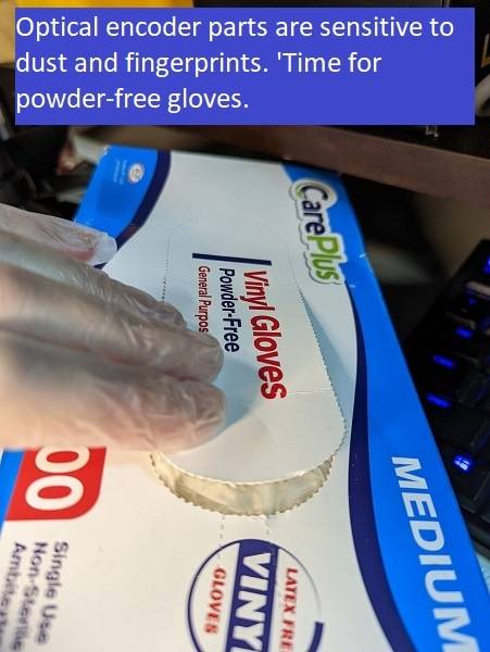

First things first. These optical encoders involve optics, so it's best to wear protective gloves to protect the optical components from my own grime and filth (See Fig. 25).

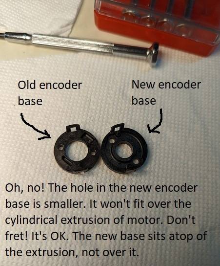

Two black plastic encoder bases on a white paper towel beside a metal screwdriver, labelled Old encoder base (left, larger central hole) and New encoder base (right, smaller hole). Caption: The hole in the new base is smaller; it sits atop the motor extrusion, not over it.
Figure 26. New encoder base vs. old encoder base.

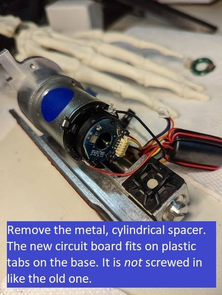

Right off the bat, you'll see some differences between the old and new encoder parts. One difference is the hole size in the encoder base (Fig. 26). I panicked when I first noticed this. But before getting any ideas about getting out the power drill and trying to make a bigger hole, realize that the new solution doesn't really need a bigger hole. Notice the screw holes on the new base are recessed in a little (compared to the old base) and that should offset some of the necessary depth that the screw needs. Also, you're not screwing in the PCB with the new solution, so that gives you some more screw depth.

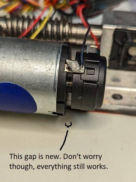

So in the end, I just let the new base sit atop the motor's cylindrical extrusion/lip, instead of around it. Everything seems to work OK with that solution.
Photo of a white plastic hand model holding a silver cylindrical encoder mounted on a red-brown metal base plate, with a blue label on the encoder body; overlaid text gives assembly tips about the metal spacer and screws.
Figure 27. Slide on temporary, cylindrical spacer to get the spacing correct when screwing in the new base.

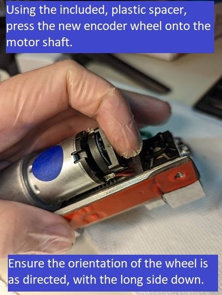

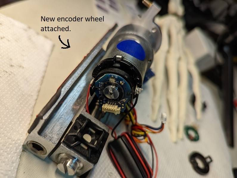

When attaching the new base, slide on the cylindrical spacer over the shaft to ensure that the spacing is all correct when the base screws are screwed in.
It might help to have a third hand (Fig. 27) if one is available (one to hold the spacer, and the others to screw in the screws), but it can be done with just two hands.

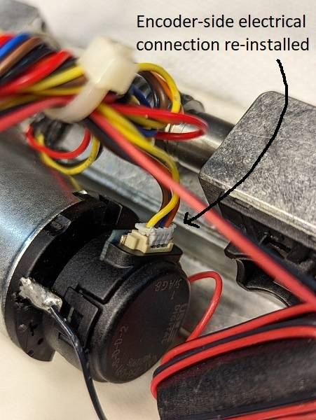

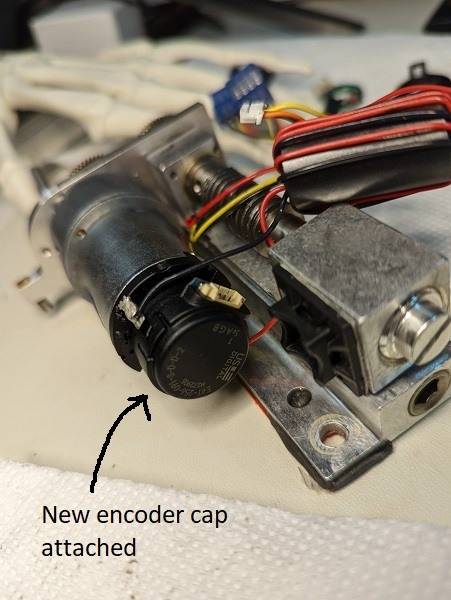

Note: Do not screw in the PCB. Unlike the old encoder, the new PCB is not held in by the screws. The screws secure the base only.
By the way, I reused the old screws when attaching the new base. I know, the new kit comes with new screws, but the old ones were a little longer and they seemed to work fine for me.

Figure 28. New PCB installation.
The new PCB (see Fig. 28) is aligned by a couple of plastic tabs on the base. It is not screwed in like the old PCB was.
Close-up of a small round encoder cap on a white padded surface, with an arrow labelled "New encoder cap" and an arrow labelled "Reflective elements" pointing to its reflective parts.
Figure 29. The new encoder cap has reflective elements built in.
Now might be a good time to examine the new encoder wheel and cap before we install them. Of specific interest, note that the new cap (Fig. 29) has reflective elements on it. In the new encoder, the cap is part of the optical path. This is different than the old encoder. Don't install the cap yet though, we need to install the wheel first.
Photo of a hand holding a motor with a blue end cap and a small black encoder wheel being pressed onto its shaft over a red circuit board; overlaid text gives assembly instructions.
Figure 30. New encoder wheel installation.
To install the new encoder wheel, place it on the shaft with the long side down (as directed in the US Digital instructions), then put the plastic spacer above the wheel. Using care, press firmly on the spacer such that the wheel slides down the shaft, and everything is pressed together and aligned correctly. Then remove the spacer.
Photo of a telescope motor with a blue-capped housing and an exposed circuit board encoder mounted on its end, with a handwritten arrow labelled "New encoder wheel attached." Wires and a metal bracket are visible.
Figure 31. New encoder wheel attached.
Fig. 31 shows the new encoder wheel attached. It looks nice.

The new encoder cap just snaps on (Fig. 32).
Close-up photo of a telescope motor assembly with a new black encoder cap attached to the motor housing, with a handwritten arrow pointing to it labelled "New encoder cap attached"; red, yellow and black wires run nearby.
Figure 32. New encoder cap installed.
Close-up photo of a motor end-cap with a black encoder housing attached, showing a visible gap between the motor casing and the encoder; the caption reads: This gap is new. Don't worry though, everything still works.
Figure 33. New gap in new encoder solution.
Fig. 33 shows the new gap due to the hole size in the new base being smaller than the cylindrical extrusion/lip in the motor housing. I was worried about this at first, but once everything was put together, it seems to hold itself in place pretty solidly.

Figure 34. Old electrical connector attached to new encoder.
The old connector attaches to the new encoder just fine. When I ordered my encoders from US Digital, I ordered new connectors too, just to be safe, in case it was the connectors that were causing the failure. But I didn't need to use one here, since the old connector seems to work just fine.
Photo of a small DC gear motor with a metal shaft and encoder cap beside a glass jar containing a grey latex face mask, with the caption "Quality inspection by Fred."
Figure 35. Fred's QA inspection of motor assembly.
Fred (Fig. 35) begrudgingly passed my handiwork as "acceptable." I was however cited for cleanliness, stating that my "overall hygiene" was of "serious concern."
Now, to prepare for re-installation, it's time to get one of those cable-ties ready. Figs. 36, 37 shows how the cable tie slides though a couple of openings in the thingy that holds the choke coil.
Close-up photo of a motor assembly with a new white cable tie threaded through a metal bracket, with coiled red, yellow and black wires and a threaded shaft visible; the printed caption reads: Insert a new cable tie where the old one used to be.
Figure 36. New cable tie. The figure shows the cable tie as it passes through one of the two openings, but it ultimately needs to go through both openings before it wraps around.
Close-up photo of a telescope motor assembly with a loosely wrapped white cable tie around a choke coil, showing the hex screw hole access; overlaid blue caption text reads "It's OK to get the new cable tie ready by loosely wrapping it around the choke coil, but don't tighten it just yet!"
Figure 37. Getting the new cable tie and choke coil ready. Don't tighten the cable tie yet! The assembly needs to be reinstalled on the telescope before the cable tie is tightened.

First thing is to make sure you have the spring (the important one, Fig. 38) and those two larger hex screws.
Hand holding a small silver motor with a blue end cap and a spring clip, circled in black marker, with a blue note reading remember that spring; screws and a hex key on a white tray and table.
Figure 38. Don't forget about that spring before you screw in the motor assembly via the two larger hex screws.
Attach the motor assembly in more-or-less the the reverse order of how it was disassembled. Just make sure that spring is in place before tightening the two larger hex screws.
Red-lit photo of a telescope declination motor assembly partly reinstalled, showing a knurled adjustment knob, a clutch cylinder and visible wiring, with a caption about reinstalling the hex screws, knob and electrical connections.
Figure 39. Reassembly.

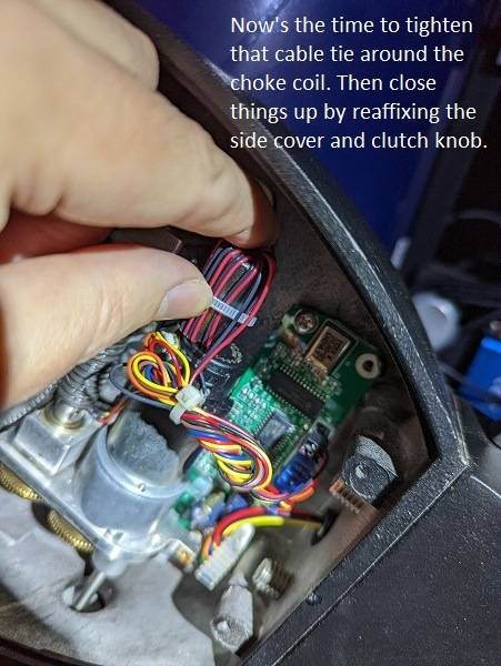

I actually used a red headlamp for reassembly. Don't forget the electrical connections (these are easy, since none of the connectors contain the same number of pins) and the declination adjustment knob.
Photo of the inside of a telescope's declination motor housing, with a hand tightening a cable tie around a coil of red, yellow and black wires above a green circuit board.
Figure 40. Tighten the cable tie after motor assembly is reinstalled.
The final step (not shown) is to first re-remove the clutch knob and cylinder thing. Be careful though! Remember, that cylinder thing can slide off and the big wheel gear is not secure. Then reattach the housing cover, and finally, carefully put the declination clutch knob and cylinder thing back on one final time.
