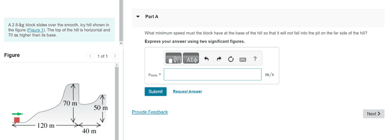

A 2.8-kg
block slides over the smooth, icy hill shown in the figure (Figure 1). The top of the hill is horizontal and 70 m
higher than its base.
Figure1 of 1
Part A
What minimum speed must the block have at the base of the hill so that it will not fall into the pit on the far side of the hill?
Express your answer using two significant figures.
I'm assuming that since this has to go over the pit, it would have to then travel 160m and since it is horizontal distance it would have something to do with Fx, and therefore W=Fd? But also, there is going to be a vertical component, in that case mgh as well, and I have to solve for speed, so I need kinetic energy as well. But am I am not sure how to approach these problems or arranging the equations.
W=Fd
KE = 1/2 mv^2
PE = mgh
What would F be here? If you are going to multiply it by a horizontal distance then it must be a horizontal force. What horizontal force?
