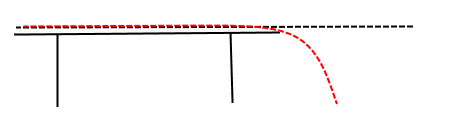

A ball rolls on a horizontal table and drops. it hits the 0.
JAZZ541
it hits the ground 0.5s after dropping and at a 40cm distance from the table.
what is the table height?
what is the ball initial speed?
in what speed (with direction) did it hit the ground
solved thee first question stuck on the other two
thx for any help!
d = v0t + ½gt2
v0 = 0
t = 0.5s
g = 10m/s2
d = 0 + ½• (10m/s2 • (0.5s)2 = 1.25m

they also ask in what direction, what does that mean?
still struggling on question 3 would appreciate any guidance, thanks again!

The ball will hit the ground at some angle above the horizontal.
Good. So the ball has 0.8 m/s horizontal speed. How much vertical speed does it have when it hits the ground ?
where?
Good thing you made a drawing. If the floor is at the end of the red line, there !
Vy(t) = V0y – gt
0 = V0y – 10m/s2 • 0.5s
V0y = 5m/s
is that right?
I would say that ##\ v_y(0) = 0 \ ## as in your first post and therefore ##v_y(0.5) = -5 ## m/s. The minus sign indicates it is going down.
So you now have horizontal and vertical speeds ##\vec v(0.5) = (0.8, -5) ## m/s. Can you calculate the magnitude of the total velocity and the angle with the horizontal ?
think I made it:Tanα = 5/0.8 → α = 80.9°
Y = 5sin80.9° = 4.937
X = 0.8cos80.9° = 0.126
4.937 + 0.126 = 5.06m/s
I would say ##-5/0.8##.
And ##v_x = 0.8, \ \ v_y = -5 ## which with Pythagoras, gives ##v^2 = 25 + 0.64 \ \Rightarrow \ v = 5.06 ## m/s
