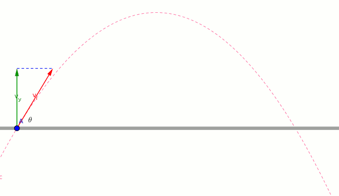

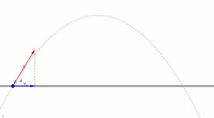

@johanMT
The pure vertical movement is independent of the trajectory because is only governed by gravity.
The pure horizontal movement is a constant velocity one (no acceleration), as long as the ball is in the air.
What we see is a simultaneous combination of both movements.
Lnewqban said:
@johanMT
View attachment 330036View attachment 330037

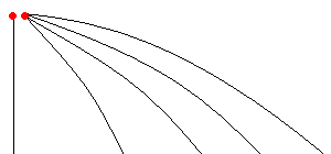

You seem confused about the concept of kicking a ball.
This is approximately the scenario you are analysing here:
Yes I see this, this is Magnuss efect.
I'm not sure about that. We are not talking about the sidespin.
The angle here is less than 30 degrees and the ball lands after less than 2 seconds. But, the critical thing is that the ball does not go straight up in the air! The ball would have landed after about 40m, perhaps.
That gives you a physical scenario to help you get a grip on the problem, hopefully.
